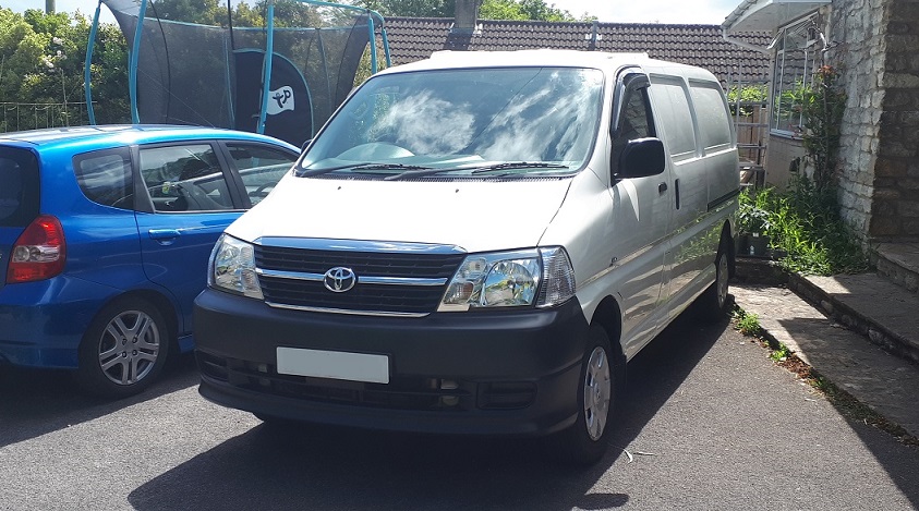

Hi all, new member from the UK.
Ive just bought a UK spec 2009 Toyota Hiace 'Powervan' with a 2KD-FTV motor, pic attached. It has factory AC (rare for these vans), but sadly it is not working.
