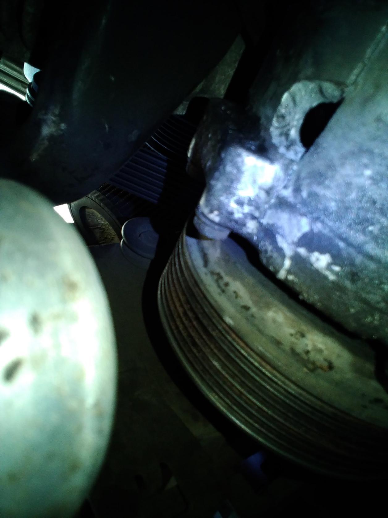

... and spilled its guts all over the road - screaming its head off, until it ran out of refrigerant.
Photo of hole:
Has *Anybody* seen an A/C compressor do *that*?
Obviously it had overpressure "Issues"... But how the **** could it do *That*?

Tim wrote: Wed Aug 05, 2026 6:18 pm It happens, normally more with the scroll compressors. What refrigerant were you using?
It's Complicated (which probably explains the trouble I got into...)
There was a slow leak at the Schrader valve on the low side... so after replacing that valve I repressurized with a can of R134A + oil from << gulp >> O'Reilly.
I undoubtedly ended up with too much oil in the system, at the very least - But I'm just amazed that *that* much pressure could have built up.
Now I'm just wondering if whatever "event" occurred to blow a hole in the housing like that, could have scattered metal fragments into the AC... i.e. do I now have to replace the condenser/drier/ etc., and flush the hoses (Etc. ...)
But if the refrigerant all exited through that hole under pressure, leaving no metal fragments behind, maybe I can get away with just replacing the compressor?
Hope Springs Eternal... but, yeah, I now realize I had it coming.

I do have the gauge set - however, I also suspect the overpressure condition could have been due to "slugging", with too much lubricant in the system -and if I understand correctly, ensuring the right amount of lubricant is in there, would require completely purging the system (with nitrogen? and I don't have a nitrogen bottle) first.. And if the dead compressor could have somehow barfed metal particles into the AC during its last gasp, before the clutch disengaged... now we're into disconnecting all the lines and flushing them with solvent and... .
So I'm hoping somebody somewhere has actually seen this type of failure before and maybe has disassembled the compressor to see exactly how it had failed, and so would know what the risk is of just replacing it (and the drier, no doubt...),
I.e., maybe "the second mouse gets the cheese"... but I definitely don't want to end up being the *first* mouse...

I've seen blown cases before involving different compressors from yours.
Depending on the size of the leak (minimal), you probably could've left well enough alone and avoided all the trouble as long as the outer cap held pressure without leaking. (See the recent topic in the Forum about that subject.)
It could've been too much oil that caused the burst case, or a fault in the casting itself.
How much new oil would you guess you added to the system before the catastrophic failure?

OK, well, the *exact* sequence of events was:
When the low side had leaked down to where the compressor wouldn't start, I
(1) Took the car to Iffy Lube, who had the necessary Infernal Machine for servicing A/C, but they said one of the Schraeder valves wouldn't hold pressure. So,
(2) because the guy at Iffy Lube didn't follow my instructions about how to hook up the Infernal Machine's A/C ports, I deicided I'd just try repressurizing myself. (After all, it was just a slow leak, right? What could go wrong?) So I
(3) Bought a can of R134a and repressurized, but
(4)) when I disconnected the can of R134a, the Schraeder valve had apparently given up entirely, so the can ejected its entire contents right back out the low side valve.port (redolent of Mt. St. Helens blowing its top.)
(3) So, I replaced the Schraeder valve / cap assembly, and after checking to make sure it didn't leak down, like before, and
(4) I repressurized - this time adding a 3 oz. can of FAG oil to replace what I imagined had been blown out the low side port (BAD assumption...).
And I lived happily ever after, for about 2 weeks when I gunned it in a hard right turn, causing the A/C compressor to Die
Screaming as it blew a hole in the side, as can be seen in the photo.
YMMV

If you had a "complete" set of gauges on this vehicle. What was your high-side pressure when you were adding refrigerant? If proper gauges were used, you would have seen the high pressure, be it from an overcharge or too much oil. As for the repair, you need to do it properly if you expect proper results. No shortcuts.

My (obviously flawed, in retrospect, with the benefit of 20-20 Hindsight - etc.) reasoning at the time was, "well, OK, it's blown out all of the oil and refrigerant when Mt. St. Helens erupted though the low side Schraeder valve, so, if I just add what the AC system requirement is when the system is completely empty, I'll be good to go".
I.e., I figured at that point, I didn't *need* to hook up the gauge set, because I *couldn't* add too much ingredients if I only added what was "supposed" to be in a completely empty AC system, as specified by The Shop Manual - right?
{wrong...}
Really, where I screwed up, was in not finding a *different* shop and getting *them* to hook up *their* Infernal Machine and completely purge and recharge the A/C...
