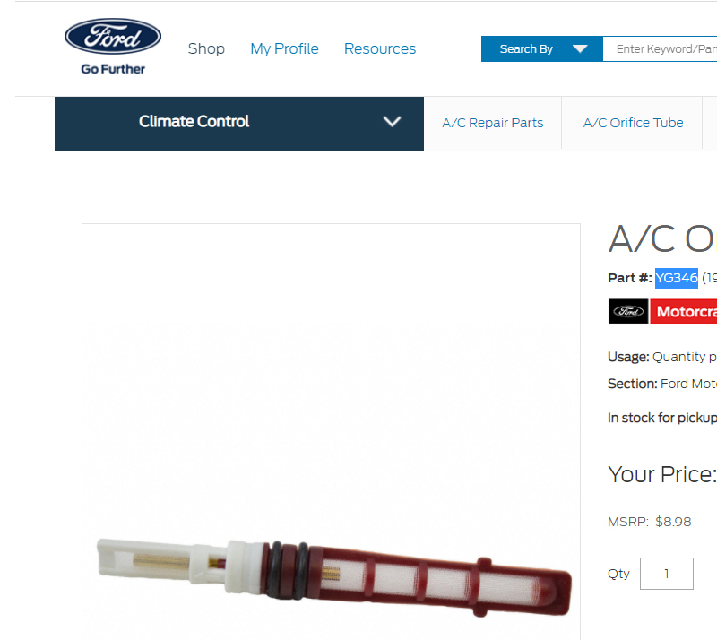

Digging into this a little deeper, there seems to be conflicting information on which OT is correct for the 2001 Excursion. My local Ford dealer lists Part Number 38639 as the red OT with a 0.062" orifice while others list the same Ford part number as the orange OT with a 0.057" orifice. Which one is correct? I don't know. However, on this vehicle, it seems to me that the orange OT would reduce the low-side pressure somewhat and lower the temperature of the evaporator (and vent temps).

Industry cross seems to be wrong on more than one site I just checked. From Motorcraft. YG346 is red.

Tim wrote: Fri Jun 25, 2021 8:12 am Industry cross seems to be wrong on more than one site I just checked. From Motorcraft. YG346 is red.
Should I put the red on back in ? It was 83 degrees this morning and my ac could only drop to 62
