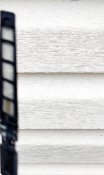

Though a little blurry, the OT appears to be OK. With the other OT removed, do you think the system will operate correctly now? In other words, do you think two OT's and a TXV were enough to cause the high head pressure?

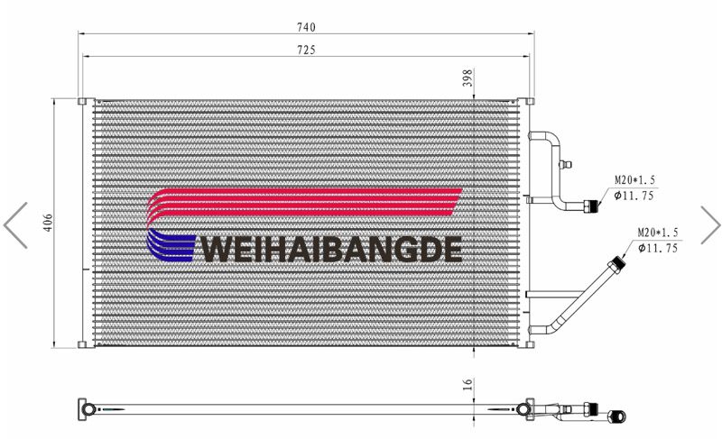

This is why we have many experts like GM Tech. I would get it back together with a single (condenser) OT and the rear valve and see what happens.
Looking at this image, it reminded me of what he mentioned. Had this happened in the shop way back when!
