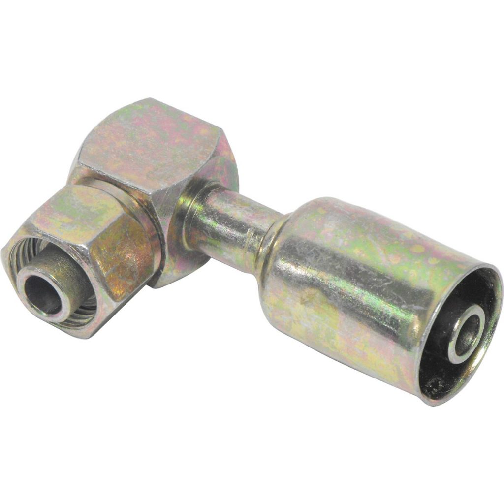

bohica2xo wrote: Mon Sep 11, 2023 6:26 pm So use the tangential exit block, and a couple of short drop 90 degree fittings.
What is a "tangential exit block"? googling that term didn't yield an applicable result.
Thanks for the alternate plumbing/fitting ideas. I miss the old printed catalogues where one could leaf through pages assembling like lego blocks. With the internet versions, one almost needs to already have an idea what they are looking for and what its called.
Re: Rotate compressor or move ports to side - generally possible? (with specifics for FS10 compressor)
Search for
Short drop 90 beadlock
That will bring up fittings
Tangential block is the one with threads sticking straight "up" in your location

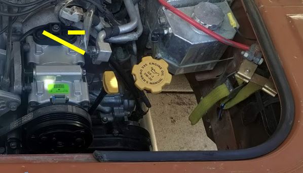

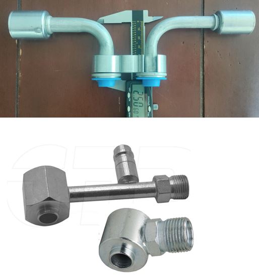

Tim wrote: Tue Sep 12, 2023 8:35 am I'd probably use this, and that's all the data I have on it.
35-39356
Thanks for that lead Tim. checked that item out (or something similar) and it is taller than the 2.5" clearance I have. I'll be trying these side fittings. The long one is by Caterpillar. the other is made by several manufacturers. I'm told the Cat one is 2.5" tall to the top of the port so it could be close.
With the long and short one I'll be at the edge of the compressor to go freely from there.
