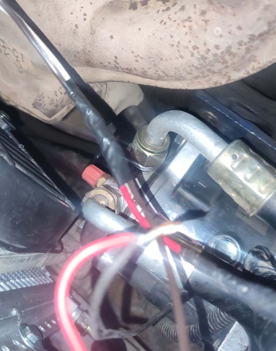

The 2 lines from the compressor are near the exahaust manifold, I will post a picture.

That comp is ridiculously close to the exhaust, and is killing your performance. Insulate that area.

About the exhaust manifold, do you have any recomendation about insulating the area?, which material to use, and should I insulate the manifold or the compressor? Do you think that could be the main problem?
