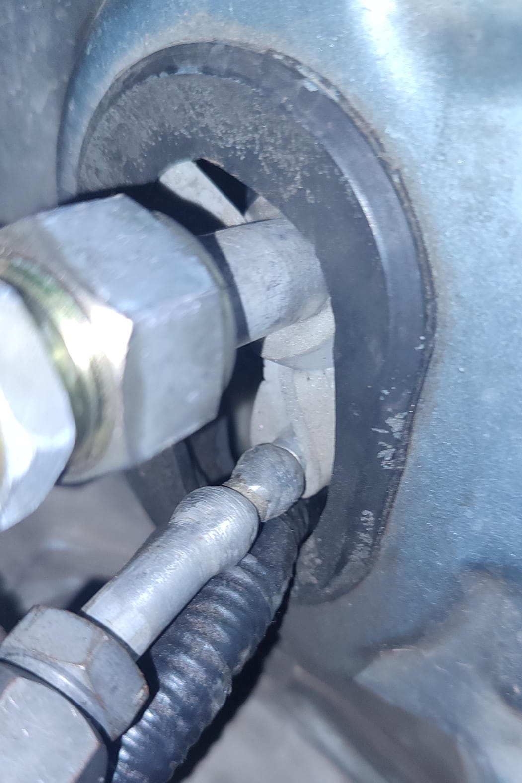

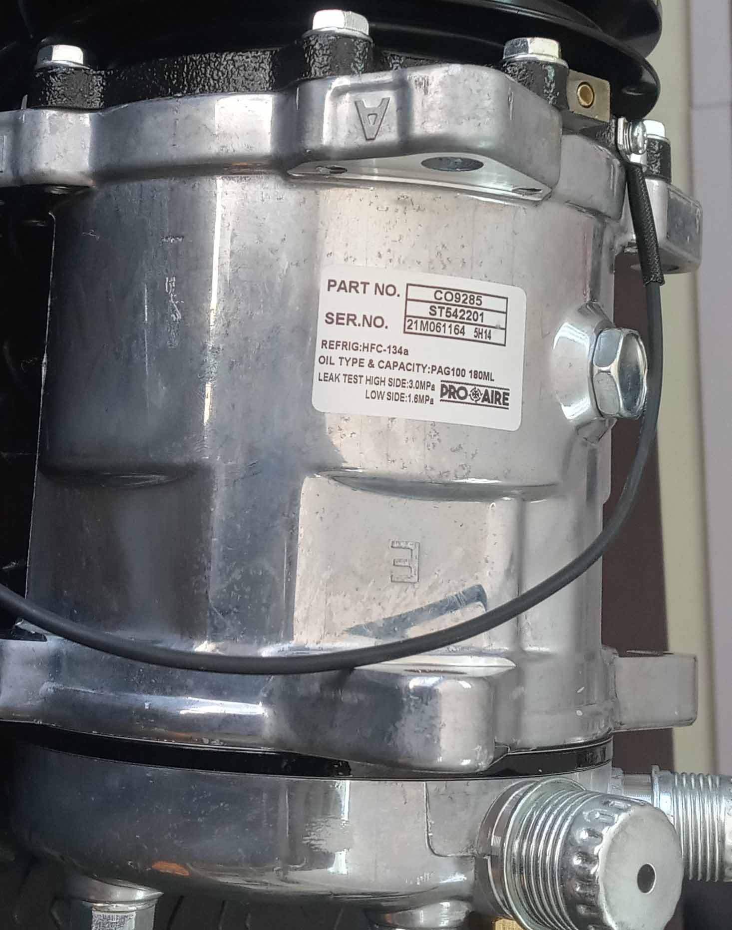

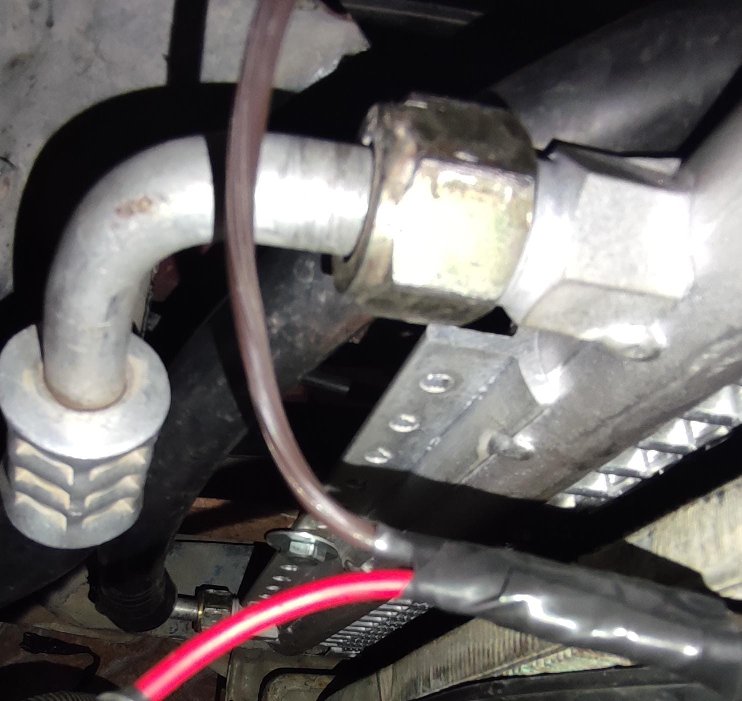

Here are some picture.
#8 at the top #6 at the bottom.
Distance between compressor and exhaust.
Hole in the firewall.

About the compressor, It is really hard to find info about this compressor, even the people of the store didn't know those details about the compressor, because I asked them about the rotation back in 2022. But I guess that most likely it is CW, I don't know why but I guess. But someone told me once that some of these universal compressors can spin in both directon and that there is no problem, but I don't know.
Ok, so I guess I have to leave the refrigerant amount alone for a moment, and pay more attention to insulate the compressor and to address the issue with the TXV right?
By the way, the picture is not from my actual compressor, because mine is not a V belt, but it is the same chinesse 508.

What refrigerant are you using?? R12 or R134 ??
I just noticed the charging ports on your comp are R12 ports.
Also, the data that Tim came up with just above shows the comp is designed to use R12.
Legitness211
Posts: 34
Joined: Sun Sep 03, 2023 7:00 am
Re: Charging a custom system.
Post by Legitness211 »
tbirdtbird wrote: Fri Sep 29, 2023 9:37 am What refrigerant are you using?? R12 or R134 ??
I'm using R134, and my compressor is for r134
