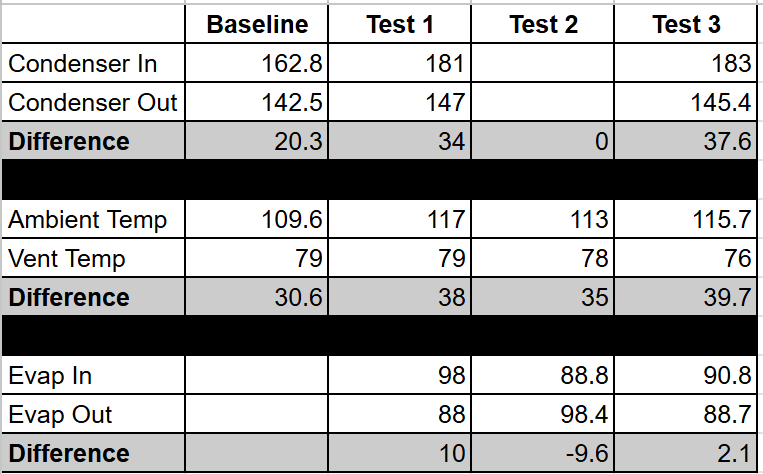

As for the approach, I decided to retry the Max Load test and record differential temps: Direct sun, all doors and windows open, and A/C set on Max Cold. However, this time I used a shop fan (rated at 6,000 cfms) to remove the variables associated with the condenser's heat transfer.
Here are my measurements and notes - I admit it isn't as scientifically accurate, since it's missing some data points on the Baseline and Test 2. It was a bit difficult to keep everything straight working in 115+ temps :)
Numbers in the chart represent the temperature in degrees
Screenshot 2025-06-17 075706.png (44.32 KiB) Viewed 12677 times
Baseline
Since my original post, I removed 2 oz from the system and proceeded to take some measurements. My condenser in / out matched the low end of the target I was aiming for (20 degrees).
The performance appeared to be slightly better; however, on a test drive at freeway speeds, I found myself getting a bit sweaty and uneasy. My analog gauge showed approximately 70-75 degrees from the vent (still welcomed at 110+ degrees).
Test 1:
I then decided to give some added focus on the evaporator temperature, after ruling out the condenser temps. The observation here was the outlet was reading 10 degrees colder than the inlet.
Suspecting an overcharge, I removed 3 oz of refrigerant. Admittedly, this occurred very fast and was more than I initially wanted.
Test 2:
I waited 5-10 minutes to let the system stabilize and took my measurements again. This time, the outlet was now 10 degrees warmer than the inlet - indicating an undercharge - fun :)
Test 3:
Before rage-quitting for the afternoon, I realized there was liquid refrigerant in the ~20 ft recovery line. Before closing out my gauges, I cycled it back into the system.
For the hell of it, I decided to read my temperatures one last time after some time had passed. The final temperatures put me within 5 degrees of the Evap In / Out - I was happy with this result.
Hope this bit of info helps someone - thanks for the consideration :)
