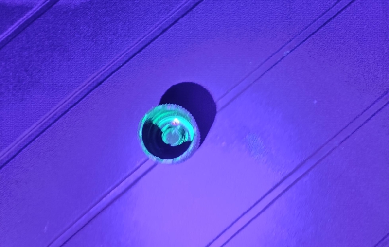

- Put dye in system - cannot see any significant signs of leakage, aside from maybe low pressure port.

Low pressure port cap

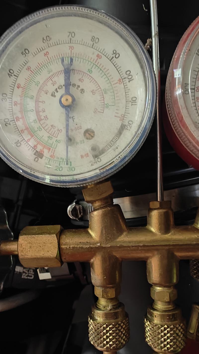

In your first photo, I see only about 26 inHg on the LS gauge. Was this reading after you let it set for 48 hours, or during evacuation? If it was during evacuation, that gauge reading suggests contaminated vacuum pump oil, a defective vacuum pump, or you live at a high elevation, in which case 26 inHg would probably be normal. Is the gauge itself zeroed?

You might not be able to find metal service-port caps to fit. Plastic caps are fine as long as the sealing rings are in place inside each cap. The cap pictured doesn't look like it has a sealing ring.
Its a home gauge ( my son is in hvac and his vac pump didn't have a fitting for my auto gauges.) That reading is after 48 hours, it was at 30 during vacuum.

I looked over the car with a UV light, looks to be previous dye splatter on the engine. Did not see a strong single source come out. I am thinking that I will recharge it, run it and have a friend with a sniffer see if anything some up for him. After that I think the next step if I can't find anything is to do a nitrogen pressure test and see what it reveals.
I planned to replace those.

Okay, that explains the gauge being calibrated for R-12, R-22, and R-502 but not for R-134a.Ex313 wrote: Wed Aug 06, 2025 8:19 pm Its a home gauge ( my son is in hvac and his vac pump didn't have a fitting for my auto gauges.) That reading is after 48 hours, it was at 30 during vacuum.
If the gauge read ~30 inHg during evacuation, that's good. But it must have lost vacuum during the 48 hours you let it set because the gauge now appears to read ~26 inHg. The discrepancy might be due to outgassing, a leak, or an uncalibrated (zeroed) gauge.

The discrepancy might be due to outgassing, a leak, or an uncalibrated (zeroed) gauge. OR a vacuum driven so-called vacuum "pump" such as you can buy at Horrible Fright was used. These devices are a joke because they CANNOT attain sufficient vacuum.
