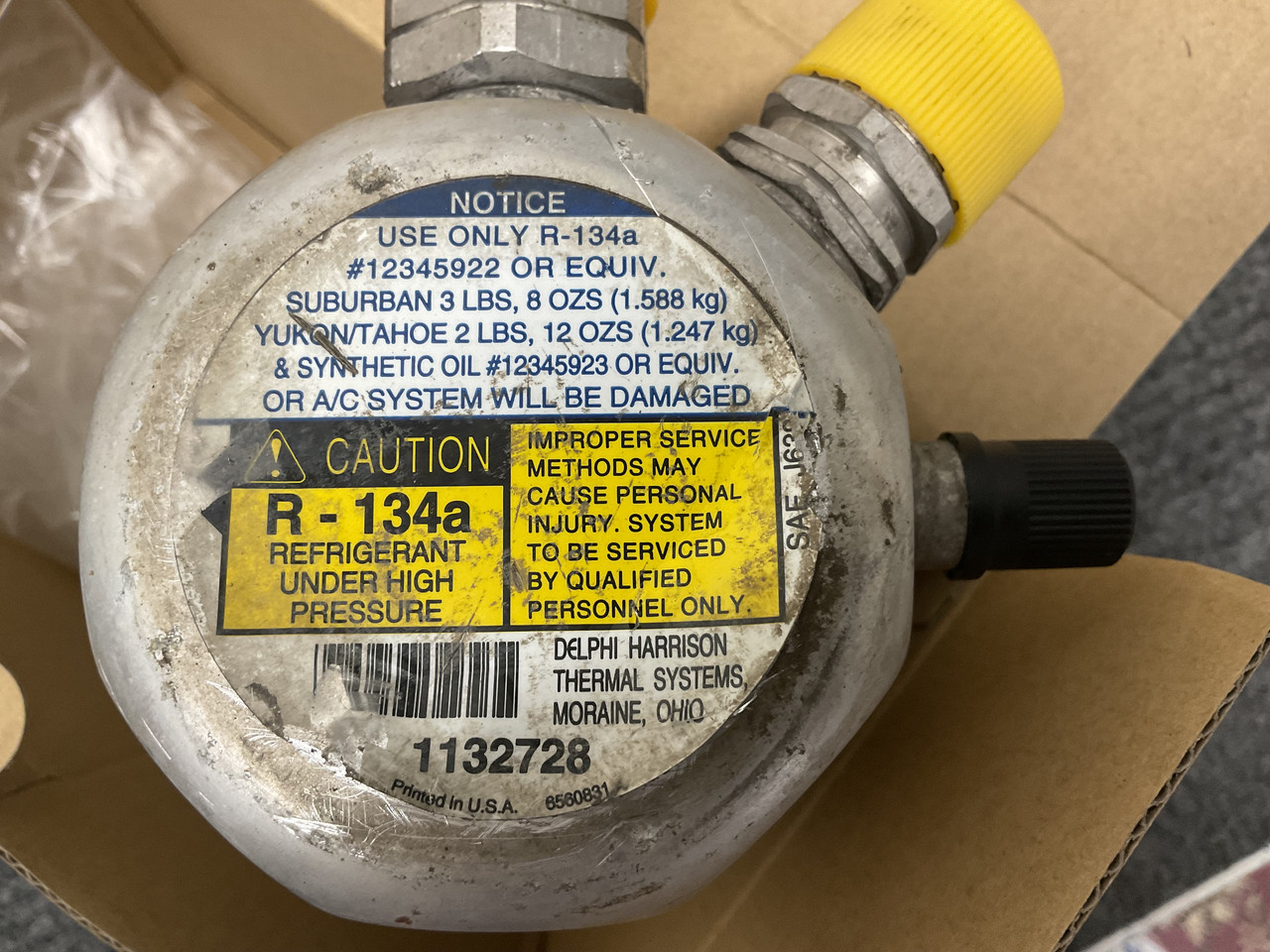

The round sticker was present on the accumulator, which I believe to be original. It states two service charge amounts, one for the "4 door utility" and one for the "suburban" I'm assuming the Yukon and Tahoe are the "4 door utility". It states 2 lbs, 12 oz for the 4 door utility, which is 44 oz. The Suburban charge is 3 lbs 8 oz or 56 oz. It gives no oil amount only to service with (GM part #) synthetic oil and to refer to manual for amount.

Interesting that in the *GPD Refrigerant & Oil Guide* that Tim posted in the Automotive Air Conditioning Procedures, Tips and FAQ sub-forum shows the same specs that I posted yesterday, which was 64 ounces net weight (4 pounds) of R-134a, and 11 fluid ounces of PAG-150. Regardless, I would still go with what the decal says for the refrigerant: 56 ounces net weight (3.5 pounds) of R-134a.

Thanks for the additional specs. After 26 years and a misplaced orifice tube, who knows if that accumulator is original. I'm guessing it is because the decal is a GM decal. I'll charge to that spec and report back on temps and pressures. I wonder if there was a TSB or other guidance from GM to increase the Freon amounts?

I agree that the decal in the photo looks like it's genuine GM, and it is somewhat cryptic. But I wonder why GM would apply it to the accumulator, a part that would normally be replaced every time the system is opened for whatever reason (and the decal lost after the first replacement). Typically, the decal is affixed to either the radiator support or to the underside of the hood.Mark86 wrote: Sat Nov 15, 2025 2:09 pm Thanks for the additional specs. After 26 years and a misplaced orifice tube, who knows if that accumulator is original. I'm guessing it is because the decal is a GM decal. I'll charge to that spec and report back on temps and pressures. I wonder if there was a TSB or other guidance from GM to increase the Freon amounts?
