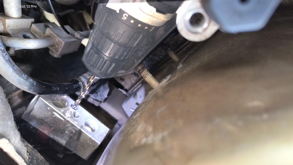

Well, my patience ran out, and the torx slot started wollering out.
After trying to work the bolts back and forth for about an hour, applying PB Blaster along the way, and getting nowhere I decided to drill the heads off the bolts.
I can tell you that trying to do that with HarborFreight Titanium drill bits doesn't cut it. I can give the Titanium bits an honorable mention against the grade 8 or grade 10 hardened bolts, but they were definitely not up to the task.
Fortunately, I also had a set of HarborFreight Cobalt bits and alas, they made quick work of those same bolt heads. It really is an amazing difference.
So with both bolts decapitated......I still can't get the expansion valve off (yet). Not sure what's holding it? It wiggles and moves and has about 1/4 inch gap between the mounting block and the Exp Valve, but it just won't let go and slide out. I kept thinking it was a small bit of the head of one (or both) bolts still hanging on just enough to keep it from coming off, but no matter how much more I drill the bolt studs....no go.
I can't say this job is a whole lotta fun at this point.
In the photo below, you can make out (barely) the remaining stud of the now decapitated bolts. Bad angle. I'll try to get another better shot and post it.
I'm going out now to get a small diameter punch and play Whack a Mole with those decapitated studs to see if I can get them to let go.

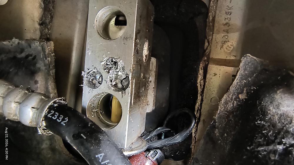

Anyone else see that strange looking section of hose next to 2332 in the photo above?
I need to investigate that. I wonder if that could be a defective hose that is collapsing under vacuum or just an optical illusion?
Posts: 1845
Re: Badly stuck expansion valve bolts - Dodge Grand Caravan
That hose is strange looking, all right. It appears to be formed that way, but who knows? Dodge might have done that for clearance purposes.
What year is your van? Using the year, you could look-up the van's OE A/C parts and see what turns up (whether the replacement line is the same).

JohnHere wrote: Sun Aug 23, 2026 7:49 am That hose is strange looking, all right. It appears to be formed that way, but who knows? Dodge might have done that for clearance purposes.
Hello JohnHere!
Yes, strange. Now that I just got the expansion valve out I'm going to take a close look at that hose.
This van is a 2001 Grand Caravan.

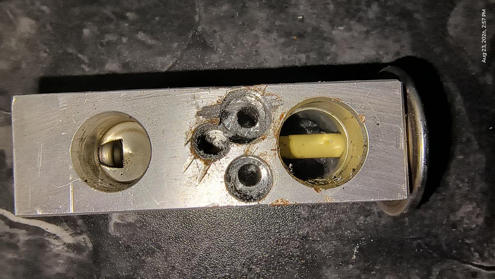

It took me quite a bit to get the heads drilled off clean enough to pull the valve out. It's very difficult to drill a concentric hole in that bolt, which is recessed and through the T-25 machined slot. Seems I went off center at some point and ended up drilling at an angle which left a small piece of the head clinging on the side of one bolt which added and extra day and 4 hours to the removal process.
I think if you could get the holes drilled dead center and straight down the center this would be a fairly quick job (with Cobalt drill bits)

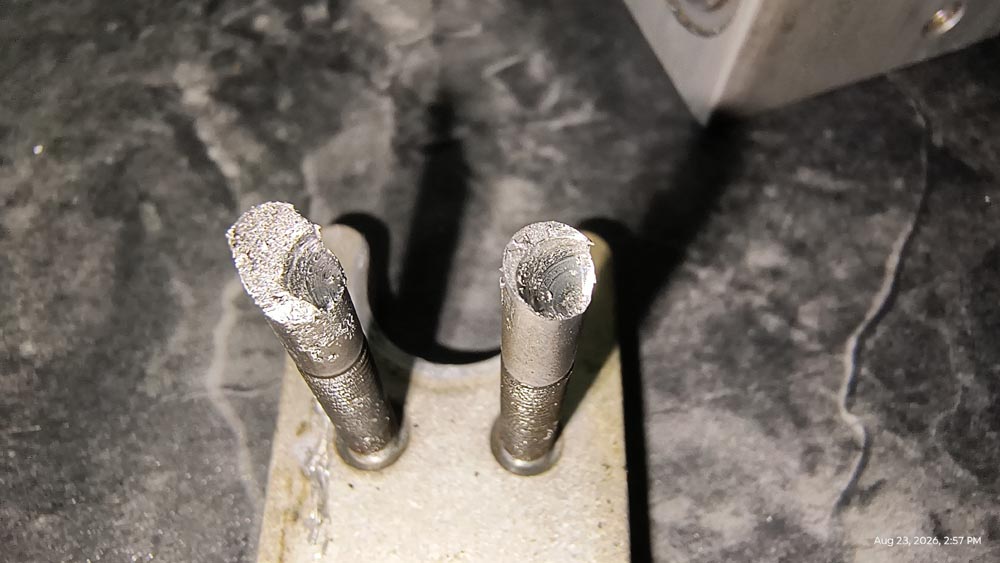

Here's a few pics of the removed parts.
The final, butchered expansion valve after all the drilling

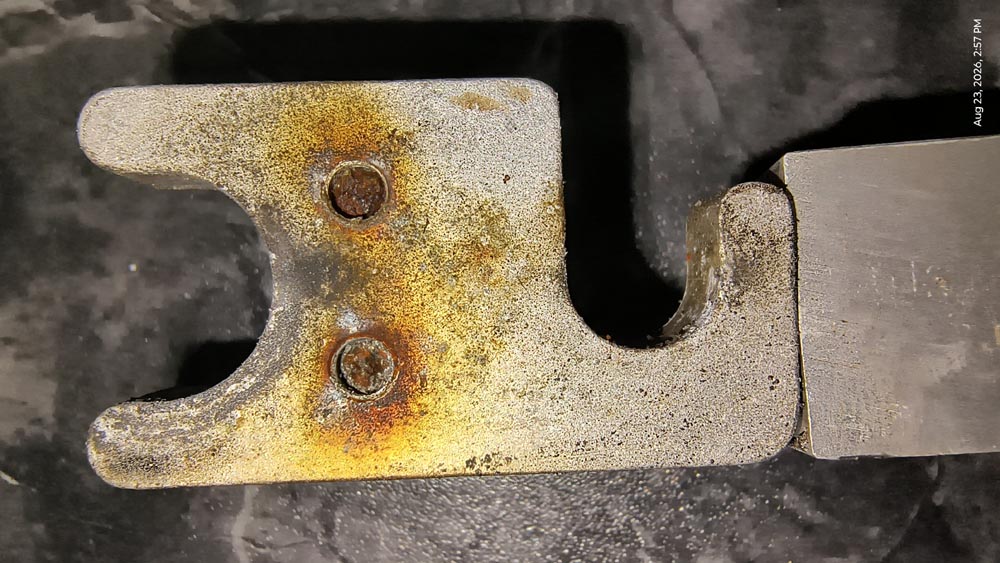

The back side of the Exp Valve mounting plate. Aluminum with steel bolts...dissimilar metals problem.
Rust! I knew it! I'm not sure exactly what yet....but I'm gonna paint the replacement bolts or use stainless or something to try and prevent this if ever I need to change this Exp Valve again. I'm gonna guess from this that this expansion valve is the original from 2001.
I'm sure these are grade 8 or grade 10 bolts. It took Cobalt bits to drill them out. Another, maybe more risky procedure to remove these bolts came to mind after it was all removed. If you're extremely careful, once you turn the two bolts as far as they can go before they jam tight, you'll get a nearly 1/4 inch gap between the mounting block and the expansion valve. in theory, you could (being extremely careful) use a dremel tool with a cutting wheel to cut the bolts in that 1/4 inch gap. Obviously it depends on whether you have room to position the tool to get the cutting disk in there. Maybe there's a better tool that you can think of that might do that?
