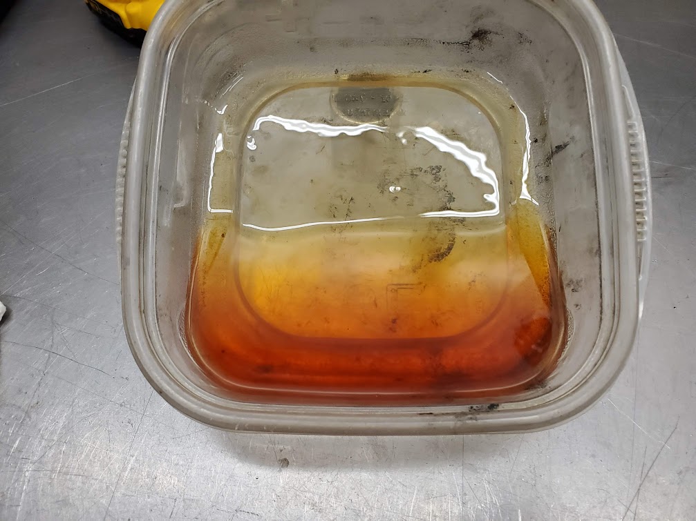

I drained the oil out of the comp, it is orange and has a sweet smell. Is there any way to easily determine if it is mineral or something else? solvent test?
Mineral is clear and odorless, but obviously any oil in system has been in contact with refrigerant, hoses and so on.
Just wondering if this is a clue to it's mysterious past life.

rattle_snake wrote: Fri May 28, 2021 1:41 pm I drained the oil out of the comp, it is orange and has a sweet smell. Is there any way to easily determine if it is mineral or something else? solvent test?
When I was working, I could use FTIR spectroscopy to tell in 5 minutes whether the recovered oil was a non-polar R-12 mineral oil or the more hydrophilic R134a PAG-type oil.
If you had small sample of PAG oil to test whether a little water could dissolve in it where mineral type oil would be immiscible, I wonder if that could work as a spot test. I'm 100 miles away from my mineral-type oil and PAG oil right now, so I cannot do such test myself; if that showed a difference, I would try some of the recovered oil.

If that is a Sanden.
PAG 100
Sanden import - aka china.
PAG 46.
Easy way to tell. Does it have R12 service ports on the back?
Mineral.
