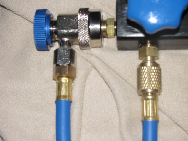

hey tbird
my gauges dont have the regular connection where the hose connects to the quick connect
heres a pic
i think there might be a o ring not sure though
can i crack this lose to bleed?

pic
Re: should i recharge or not
I have a different setup. I am gonna suggest something I have not tried myself. Others will correct me if I am wrong.
With the quick coupler off the resting fitting on the gauge set, and your 134 going up the yellow service hose,and the blue hand wheel open, what happens if you screw the thumb wheel in, that should open the valve and accomplish bleeding

i tried and opening the quick connect with the 134a going in and it didnt bleed
with the 134a still in and my swimming goggles on i cracked the connection at the fitting with two wrenches and it bleed out without a blow out of any o ring
now im set to recharge when the time comes
thanks
OK, there should be an easier way.
I just loosen my hoses a little (with the knurl) right at the quick connect.
You do not have that knurl, but there has to be a way

I take this to say, he opened a fitting on the actual system. Hopefully, I'm wrong.
Don't think so. Based on the pic, I believe he cracked the fitting where his hose connects to the body of the coupler. I expect it is an ORing connection.

Hope so.
Odd since the hose on the manifold would do the same.
