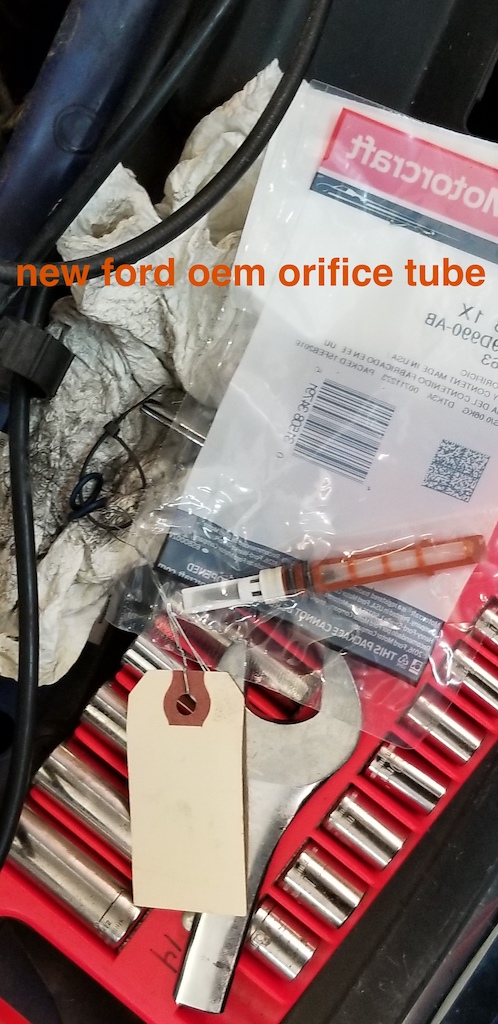

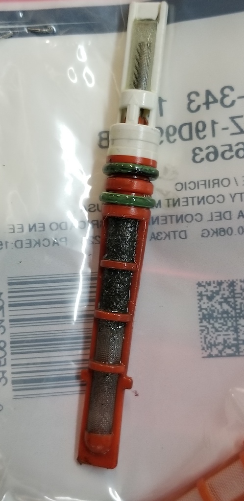

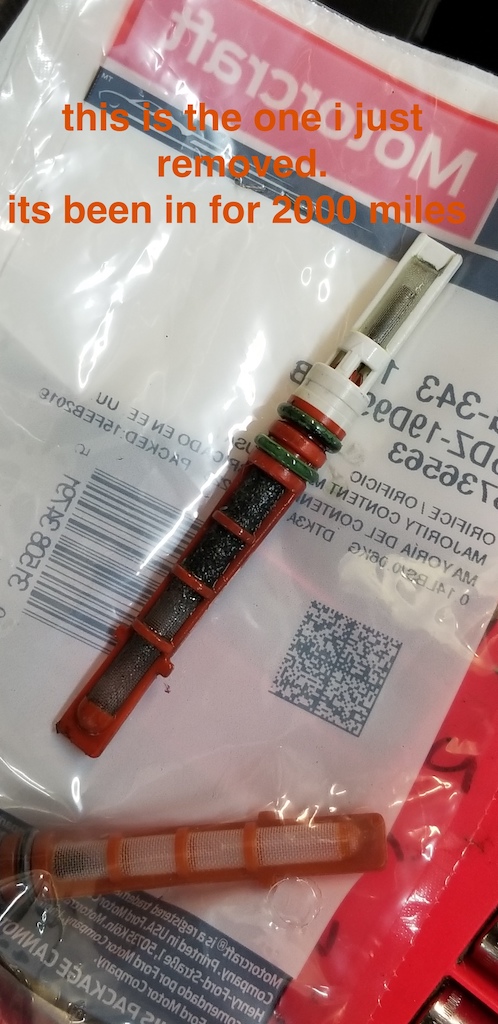

Update time. Since I last posted I have completed the change out of the orfice tube with an OEM one. I will post pics of the orfice tube I removed.
I pulled a vacuum on it for 7 hours and then shut the gauges and let it sit overnight. It went from 29 in to 27 overnight. Thats good enough for me and could be because of the crappy HF gauges or any number of connection points of the gauges. I dropped 26oz of liquid in the low side and let it equalize. started the car in the garage and it was blowing ice cold air in the low 40's. fast forward a couple weeks I think and I still have sub par performance during driving and especially on hot days. and yet another issue cropped up yesterday on the trip to the drs office. the blower motor started surging and I could hear a relay clicking under the dash during the surging. its crazy . it comes and goes. this damn car hates my guts. right after my back got better and before these problems, I changed out both rear shocks, both stabler arm end links and both struts. it needed them in a big way. I get one issue fixed and it throws 2 more back at me. I hate this damn car and it hates me. its mutual. I had forgotten what a true pain in the ass that orifice tube was to get to. I had to fab up a couple of stubby wrenches cut and bent from full size wrenches to get down in there. I dont ever want to change the damn thing again.

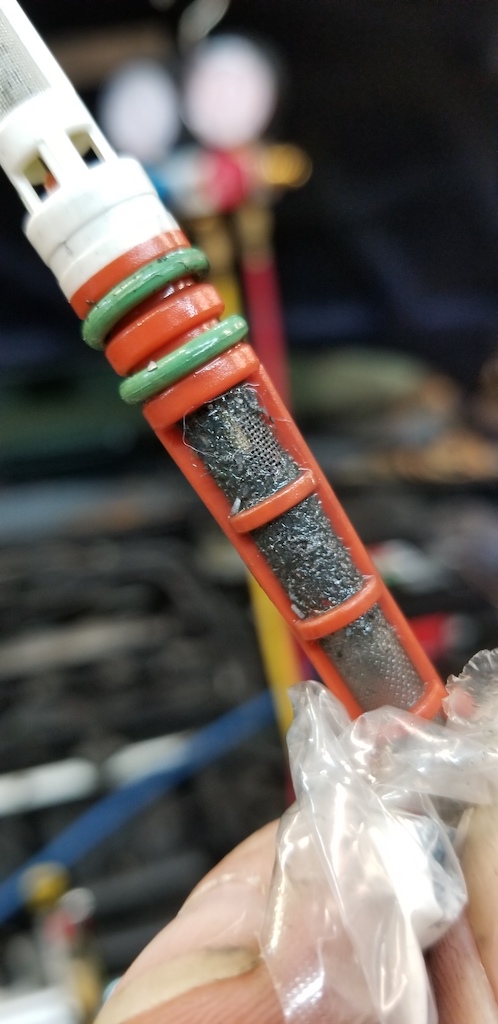

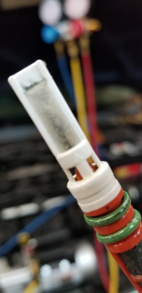

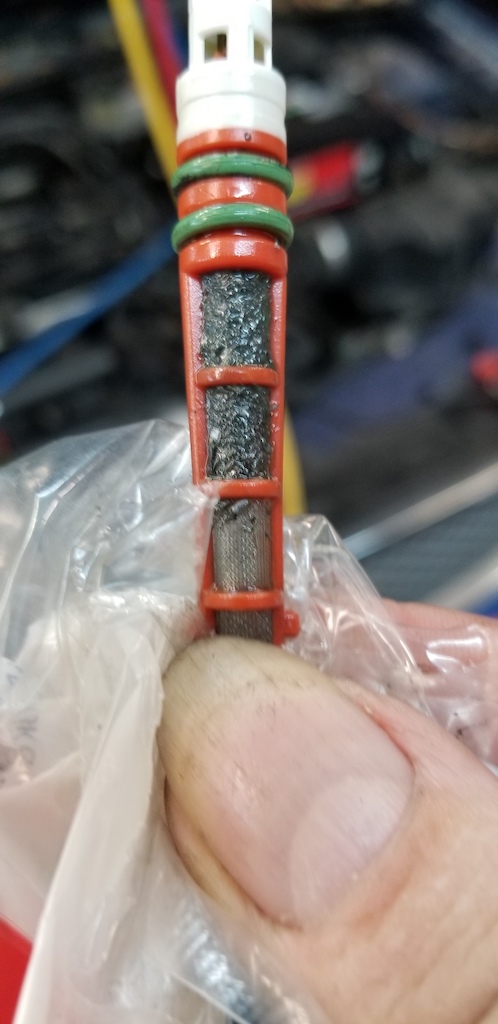

next set of pics. it only let me put in 3 at a time

That is some nasty crap on the OT.

The deposits on the OT screen suggest that there's still debris inside the system that wasn't eliminated with the first round of parts replacement. Its source could be the evaporator, which I think you said earlier wasn't flushed. It's a real pain, I know, but the evaporator and all other flush-able components will have to be removed, thoroughly solvent flushed, thoroughly dried, and reinstalled. The compressor should be flushed several times only with the appropriate PAG oil. You'll need to replace the accumulator again, too. You might also have questionable HPCO/LPCO switches. So I think I would replace them as well while the system is open.
