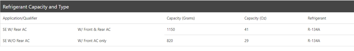

I checked the tag again and these specs are correct. Damn if I know what I was looking at. So my system is low at the moment. But is it ok to keep adding refrigerant? The high side climbs with every little bit I add.
Posts: 1749
Re: 2012 Dodge Grand Caravan AC issue driving me nuts.
Septaric wrote: Mon Jun 21, 2021 12:23 pm Your specs are way off. The tag on the vehicle are something like 1.6 pounds for single, 2.6 for double. That's off memory so it's not exact.
Your memory was pretty close to the actual: 6 cyl. 3.6L eng., without rear A/C -- 29 ounces (1.8 pounds) of R-134a and 4.0 ounces of PAG-46.
Same engine, with rear A/C -- 40.5 ounces (2.5 pounds) of R-134a and 5 ounces of PAG-46, which is what I said earlier and also tracks with what Tim said for the refrigerant amount.
