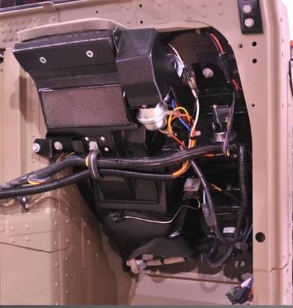

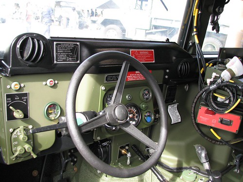

Here is the front evap and heater core, and shown in place, then the plenum that goes across the dash attaches to the evap ass.
Not allot of good pictures out there.

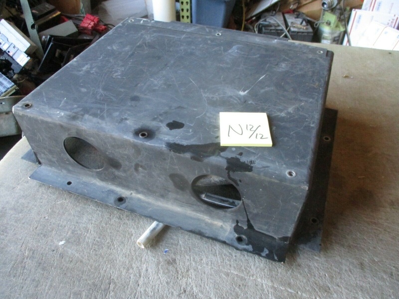

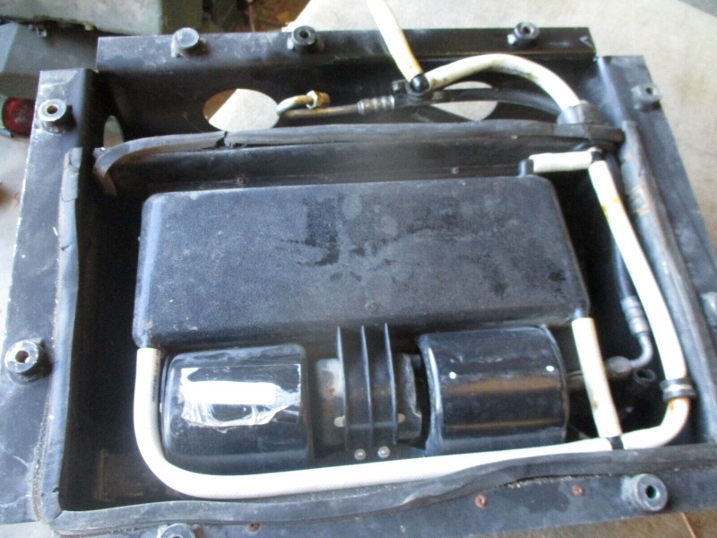

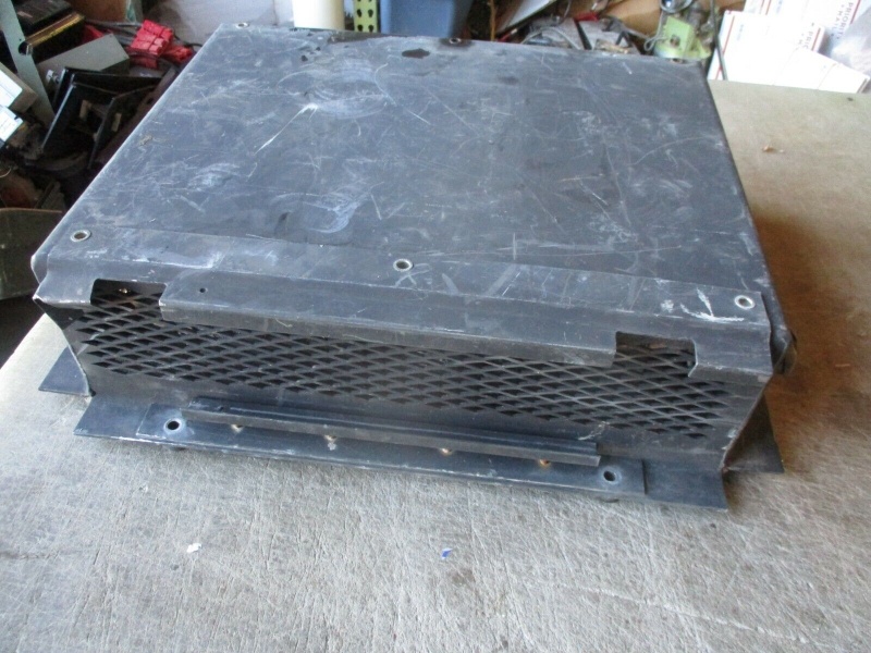

The rear evap sits on the floor (elbow high to passenger) between the rear seats, I hope to invert the evap in that housing so I can flip it and mount it to the ceiling.
I also may use an aftermarket rear evep if the factory one gets to be a big hassle, not going to be dropping shell casings on or standing on it so it does not need to be so heavy.
But I need that area between the read seats to be able to be able to lay in the back

The front system looks like it probably does the job, and is well integrated with the vehicle. A 4 port heater core bypass to keep the hot water out of the cockpit is probably on the vehicle someplace - if not add one.
The condensers look solid. Can you put fans on the second condenser?

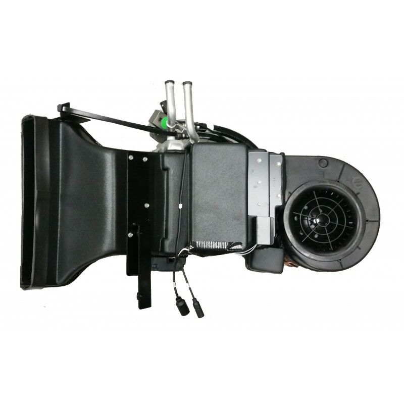

The rear evaporator looks suspiciously like a small underdash unit in a steel box. That we can upgrade easily
https://www.ackits.com/evap-assy-minibu ... ch=30-0122
I have seen this unit mounted at the rear ceiling of shuttle busses several times. Basically a double width version of what is in that box, with 2 blower motors and 4 fan wheels. Ready to mount underneath a surface. And available from the site sponsor.

I wonder if that evap has an expansion valve?

That aftermarket evap looks good, I did find the specs and it does come with an expansion valve, the only down side is I can install 90 degree vents on the stock unit to blow down onto the rear passengers as the evap will be pretty much directly above the passengers.

Re: Newbie, installing "custom" system
Yes that evaporator has an expansion valve, and has O ring ports. It is 27 inches wide and 5.75 inches thick
The vents will direct downward, not straight down but they do blow at the seats in a van. Cold air falls pretty well.
I think you will want the remote fan control. With a rear TXV you shut down the airflow and it goes to minimum flow. It still keeps the oil returning in the system when the rear cooling is not in use.
