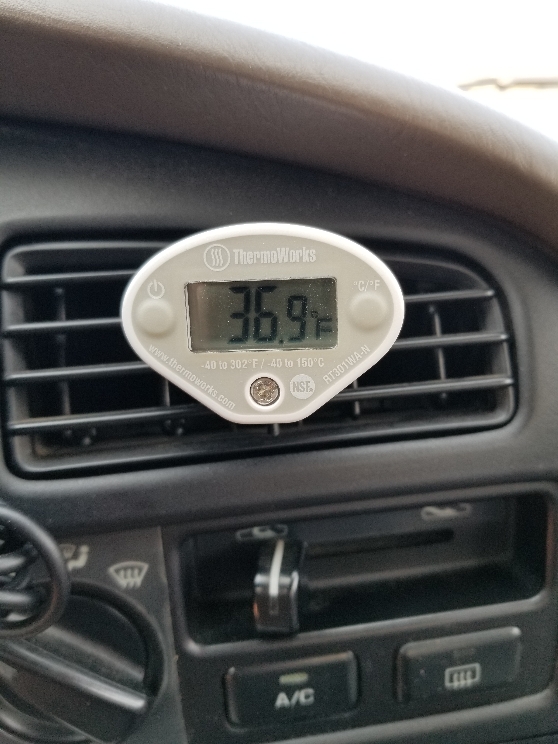

I recorded the nice, cool temperature in the photo (right-center vent) the other day after driving around on local roads for about 15 minutes in my 1994 Toyota Camry Wagon on a 99-degree day here in humid South Carolina.
This car has a TXV system as opposed to your CCOT set-up and also has a new evaporator.
In addition, I installed a new condenser, OEM TXV, R/D, and OEM Denso compressor. I flushed all the lines and hoses. Evacuated overnight, about 8 hours, and charged it with 30 ounces of R-134a. This system also contains 8 ounces of PAG-46.
It can be done.
It can be done.

Re: 1995 Buick Lesabre
Nice going John, you da man!! Great temp after a total rebuild!
What was your micron reading after that pulldown? Gonna guess less than 200

I don't recall the exact reading, but I do remember it being nice and low. Around 200 microns is definitely in the ballpark. Since it is my own car, I had the time, so I evacuated overnight. I'm glad I did.tbirdtbird wrote: Fri Jul 22, 2022 12:38 pm What was your micron reading after that pulldown? Gonna guess less than 200
