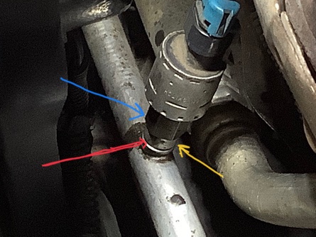

I took a pic, but is too large to upload here. I’m struggling to find a part number for that switch, so I was going to remove, inspect and or take to the parts house in hand to compare to the replacement,
As mentioned I got 4-5 turns on it before it began leaking, which is ample to have a leak. It also kept leaking until tightened with wrench.
Looks like maybe there is a valve, and I was unscrewing that, vs, just the switch. May need to grab that with a needle nose to hold in place,

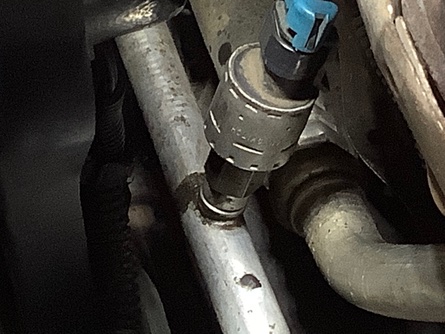

Pic. Had to resize

Agree it does not appear to have enough depth to the fitting on the pipe to include a schrader fitting.
Once someone recovers/recharges, before they recharge, there are adapters available that could be installed to provide a schrader base. Tim, the site owner, may have something available, doubt it would be in his web catalogue, why not call him and ask, he is a most helpful person. Otherwise try online.
I suspect that may be a 1/8th NPT fitting, but it could be machine thread
Re: 1995 Buick Lesabre
On second thought, try to get a shot that is more perpendicular to the pipe, ie not at an angle. There is a possibility that if you were wrenching on the hex, perhaps THAT is the schrader adapter, and the barrel shaped part unscrews separately off that.
Am I seeing a PN on the switch body? Go around it with a mirror...
Also, have you tried removing and installing the electrical connector several times to wipe the contacts ? Sometimes they oxidize.
Also, I would remove the connector and using a VOM measure the resistance across the switch under varying running conditions, such as Off-low cool-high cool before you condemn it

Red line is pointing to a mating surface. Yellow line is pointing to the boss which the switch mounts. The blue is pointing to the base / female fitting of the switch.
