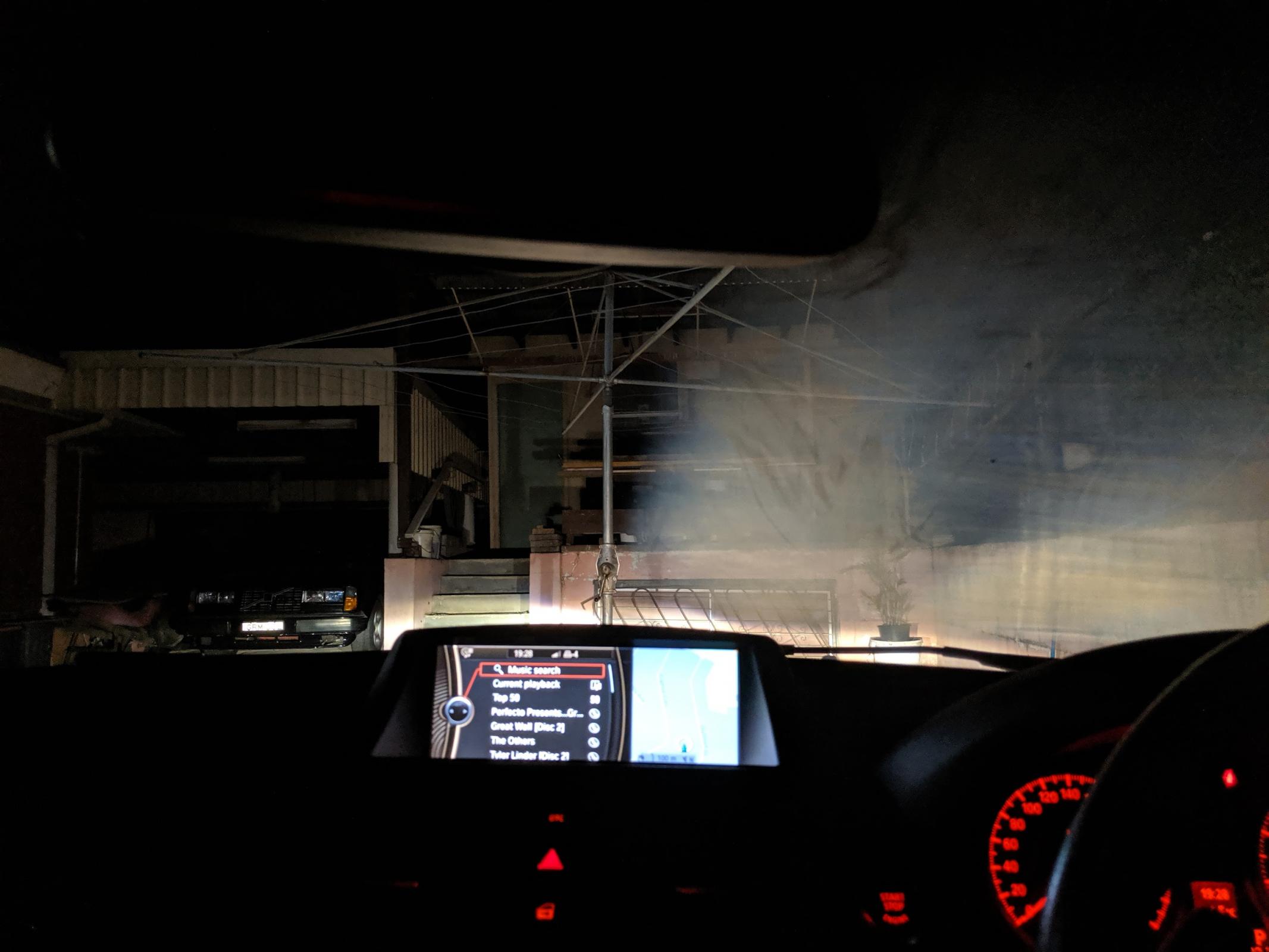

Recently, my RHD 2010 BMW 135i N55 coupe has had the driver's side of the windscreen fog up almost during every drive. It's exactly the driver's half of the windscreen, the passenger side is unaffected. Using the windscreen de-fog button will clear the fog away but when I stop using it, that half fogs back up again.
I have also noticed that occasionally the driver's face vents (vent to the right of the steering wheel, and the right-side centre vent) will emit a visible fog/mist when the fan is on a higher setting. The fog disappears almost immediately after exiting the vent, is odourless, and the air conditioning temperature is fine and working as set. Again, this does not occur from the passenger side. The car has dual zone climate control, but the issue occurs when both zones are at the same temperature.
I always have the air conditioning set to auto on the lowest setting, anywhere between 20-24 degrees celsius. The recirculate setting is also set to auto.
I have checked the drain and water is draining properly under the car. When set to cool, the air is cold and feels like the system is working correctly, but gradually the windscreen (and eventually other windows in the car) will fog up or start to leave a sheen.
See below photo of the fogging issue.
Any suggestions or advice greatly appreciated!
