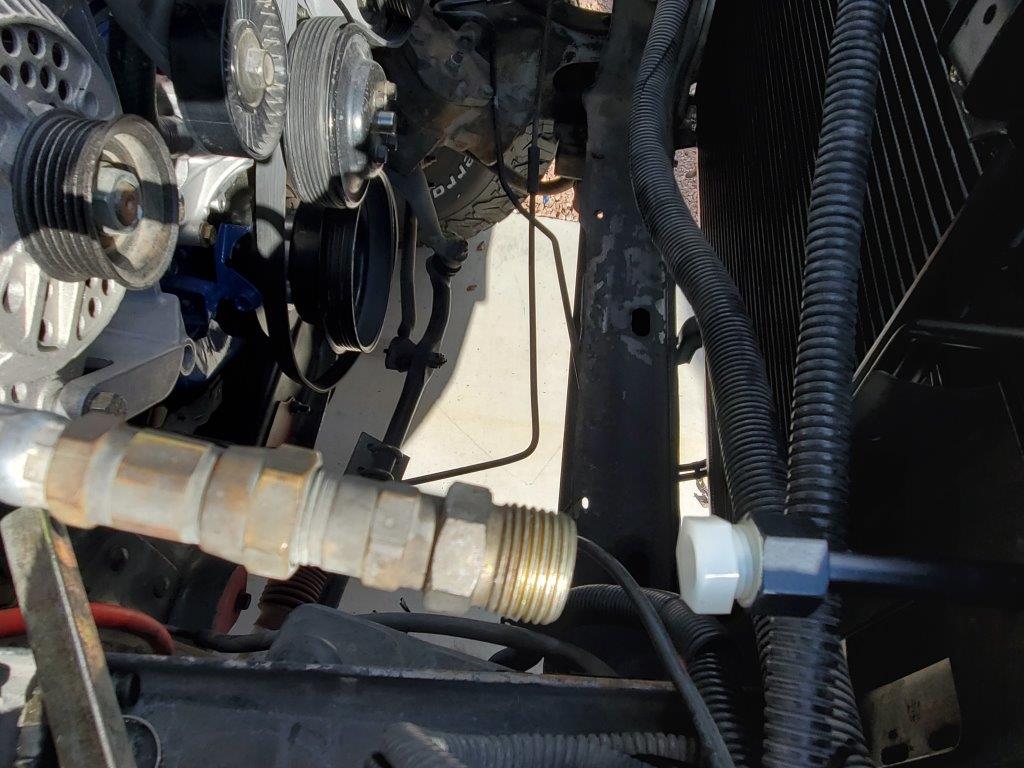

Brings me to the current situation. I am currently upgrading the engine from a 302 to a 351 and that necessitated switching to a newer style compressor, which led to other things. One of those other things is a parallel flow condenser from a 1995-6 F-Series/Bronco. It fits fine, with one exception. The connection from the condenser on the passenger side. See the attached pic. The existing line is a bit short and the fitting it the wrong size. Not exactly sure how to measure/describe the two. But the condenser fitting on the drivers side would match up to to the line on the passenger side.
Is there some adapter that I could use to fill up the gap and connect the two? Maybe even remove the adapter that is there?
My other thought would be to get a rigid line from a 95/96 and braze a larger end from the 87-93 to where it would attach to the accumulator/dryer.
Thoughts?

Time to have a new liquid line made up to run from the new condenser to the OT connection at the evaporator.
All Hose on Post Road in Las Vegas can do the job if you are still here in town
That brass fitting stack in your picture is one of Ford's mystery dry break connectors. Randomly appearing on various models across 20 model years. If can be removed from the system. We always guessed it was for sweep charging on the assembly line. Sort of like the plastic plug in the C6 transmission pan...
Good to see you back
B.
B.

Hey B.
Yeah I love the old truck. I have had it almost 30 years now. I send a lot of people this way for solid info. Thanks for being here.
So while I am here, where could I find the specs for the 1993 system? (amount of oil and charge).
Would they have the parts or should I do what I was thinking and grab a newer rigid line and get a new end put on it?
Also, what ends am I looking for?

The 96 is a mystery to me too. But in those years there was still Dealer installed A/C with an SD709 compressor on some trucks (I have one) So perhaps that reflects that. Or perhaps rear A/C? Just like the random dry break connectors - say Ford, shake your head and move on.
Your plan for 7+ ounces of oil sounds good. Replacing the line with the "cans" is also very possible if you want to - they are not reasonable to flush.
You have another version of the custom system you had 13 years ago. Charge it just like you did in that thread:
https://www.autoacforum.com/messageview ... adid=17615
Except a pressure ratio of 2.5 to 2.7 x ambient is more in line with the Parallel Flow condenser you have now.
