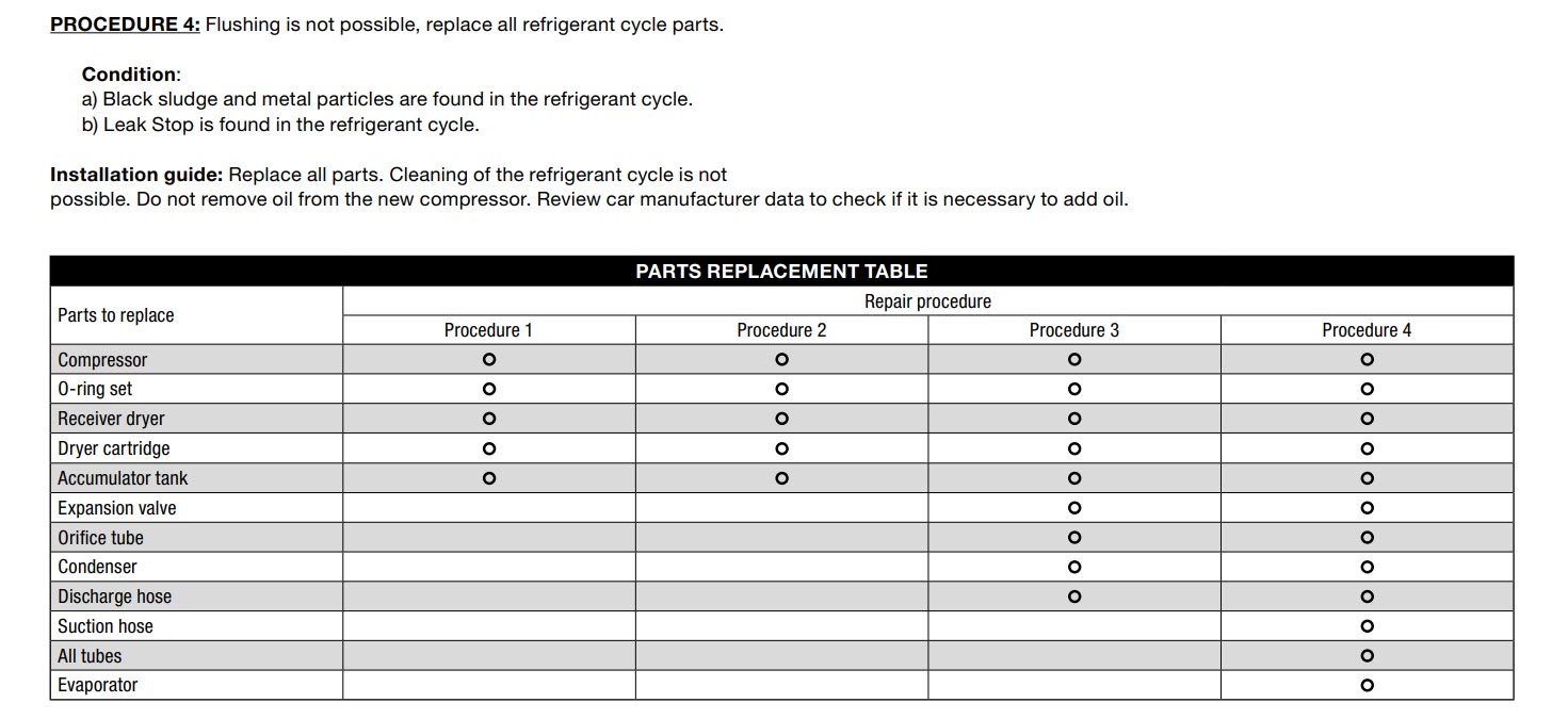

I have checked DENSO website (the OEM manufacturer of my car compressor) and they truly recommends replacing all refrigerant cycle parts if black sludge and metal particles are found in the refrigerant cycle. They say that flushing is not possible in this case.

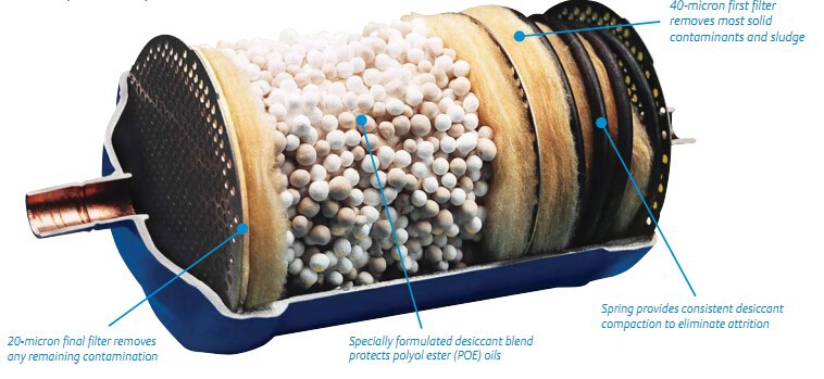

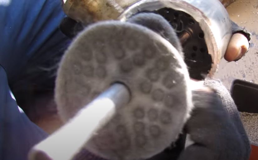

I have noted that some old cars utilize a more complicated receiver/ drier system that features a fiber or fine strainer filter besides , of course the desicant particles. Such filters are supposed to provide more protection for the A/C system from solids, water and acid contaminantns. I am wondering if it is feasible to install a similar receiver/ drier in my A/C system and what maybe the drawbacks of such a modification?bohica2xo wrote: Once a compressor fails the condenser is the primary filter and must be replaced. Adding a filter to the suction line on a new compressor & trying to let it flush the system will not clear a plugged passage in a parallel flow condenser.
The receiver / dryer on a TXV system will catch some trash - but it is NOT a filter. This is why Toyota says TSR on a failed compressor for that car. Because it can run for months making trash while you drive with the heater on.
