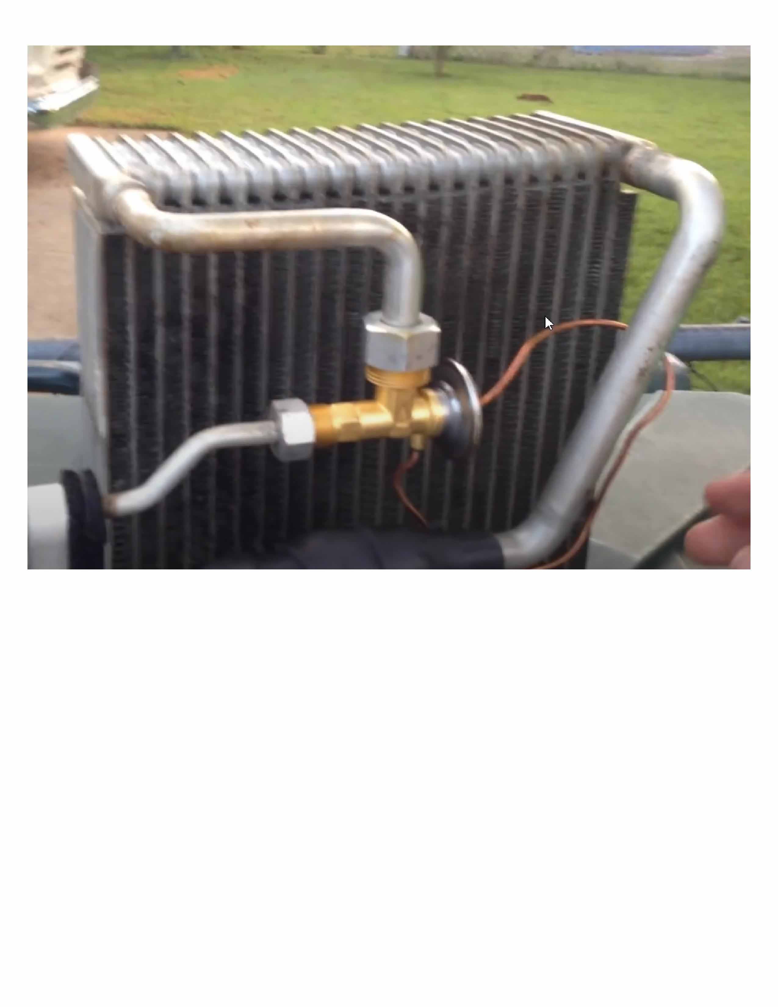

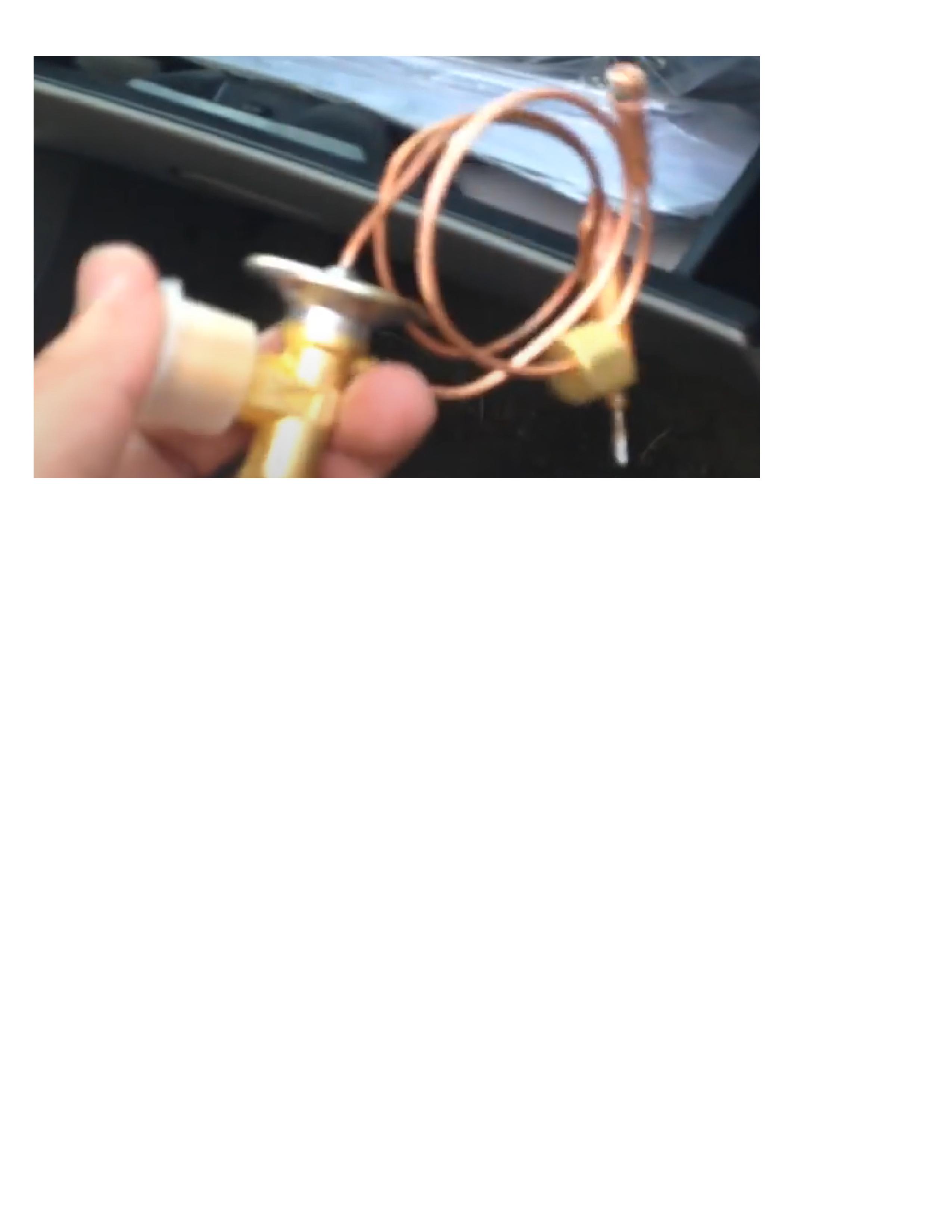

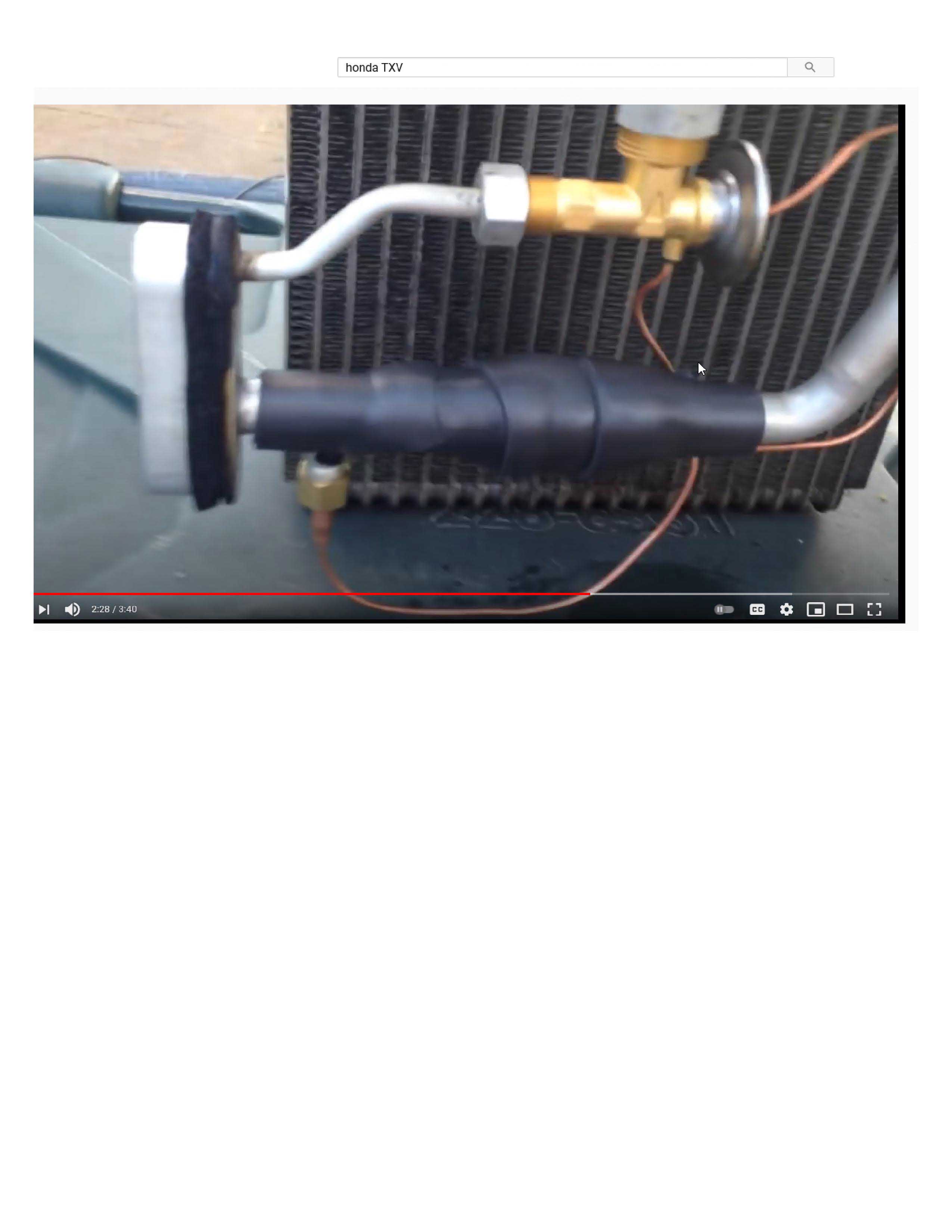

From the attached 3 photos of a 2000 Civic (that I would expect to be similar to my car with regard to the AC system) it appears that the TXV has a sensing bulb. So my car set-up should be similar to the set-up of a residential unit.
Could you please clarify your statement ‘The refrigerant amount in a MVAC system is charged exclusively by weight’? Could you please explain the function of the equalizer (?) line between the valve and the evaporator discharge line in Photo3?

Charles5654 wrote: Wed Mar 24, 2021 11:37 amCould you please explain the function of the equalizer (?) line between the valve and the evaporator discharge line in Photo3?
Ahh...now you're entering into the realm of refrigeration theory.
Essentially, a TXV, which meters the flow of liquid refrigerant into the evaporator, is all about pressure relationships at three different points internally. The three pressure points interact with one another to achieve a correct balance which, as you'll see, is very important.
Without getting into a detailed discussion of superheat, the TXV needs to meter the flow of liquid refrigerant into the evaporator at the same rate as the refrigerant is changing state from a liquid to a gas caused by the heat load. The three aforementioned pressure points, working together, cause an internal needle valve to allow more or less refrigerant into the evaporator so that the refrigerant "evaporates" within the evaporator, thereby creating the desired refrigeration effect and cooling the cabin when air is blown across it.
For the externally equalized TXV in your pictures, the equalization tube compensates for a slight pressure drop across the evaporator by providing "equalization" pressure from the evaporator suction line to the bottom of the TXV diaphragm. An internal superheat spring also acts on the bottom of the diaphragm. Both of these forces coordinate with the pressure at the top of the diaphragm generated by the sensing-bulb tube, thus controlling the needle-valve's throttling action.
This rather complex pressure relationship ensures that the correct amount of liquid refrigerant always enters the evaporator via the internal needle valve at any given time.
