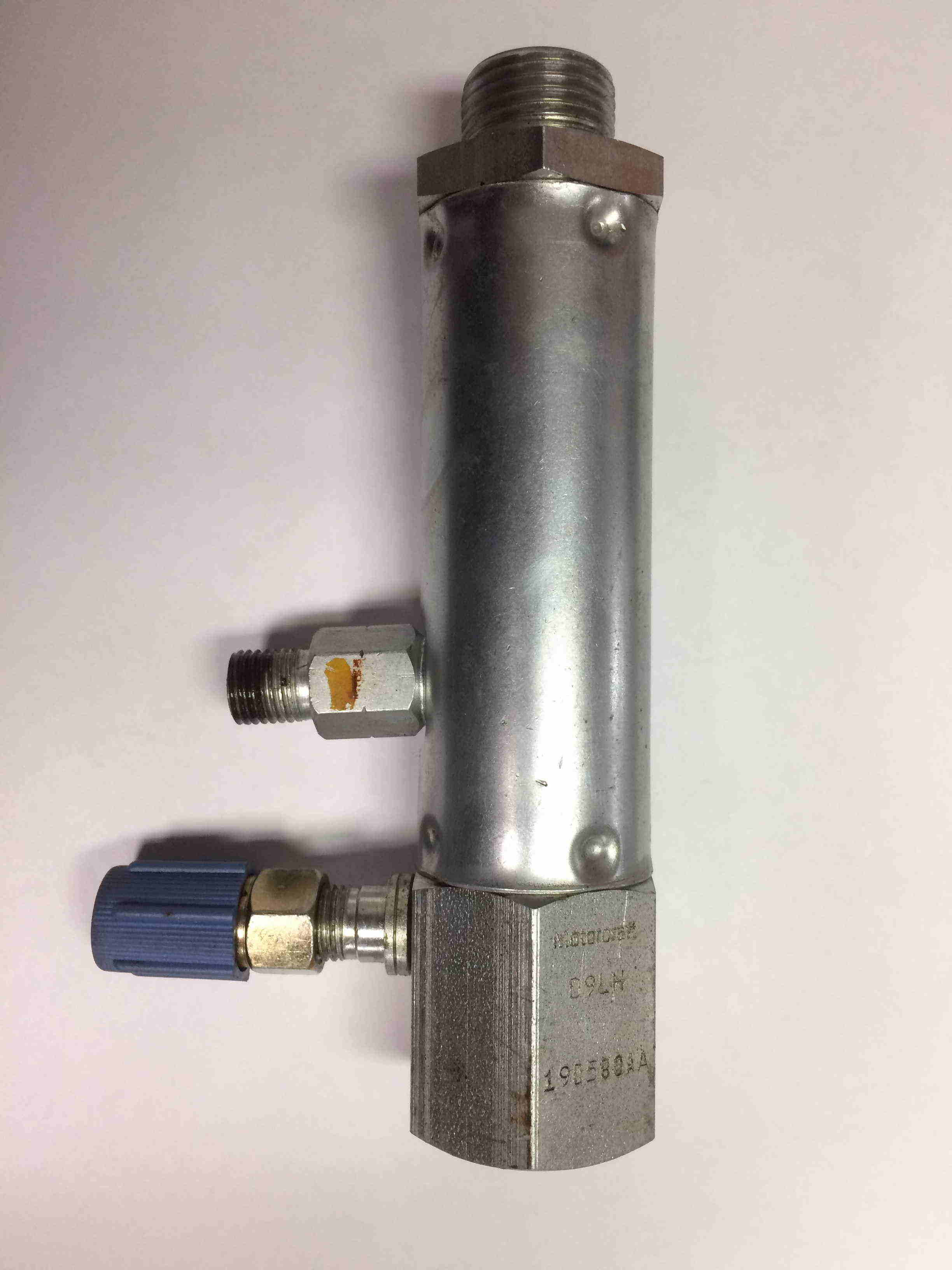

This is the valve. I released the car to the customer until I learn what to do here.
- AC POA valve2.jpg (250.62 KiB) Viewed 17852 times
- Posts: 1822
Re: 1979 Lincoln ATC
Yes, the part in the photo appears to be a stock Ford POA valve (or Suction Throttling Valve, as we used to call them) from that vintage and not a POA eliminator. I wonder, though, whether it has been recalibrated from the original R-12 spec to that for R-134a. The pressures are different.
