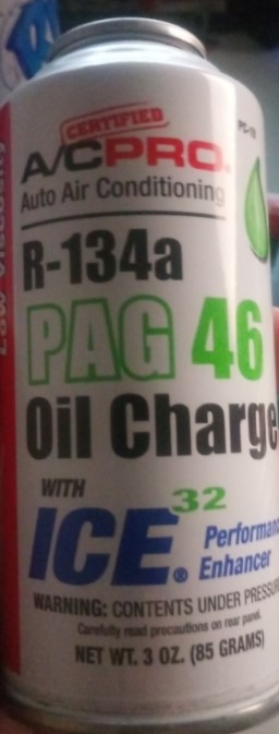

So I recharged the system added oil too. (did not have a/c gauges yet, used the Ac pro can gauge only filled to about 32 psi@72°F on the low side)

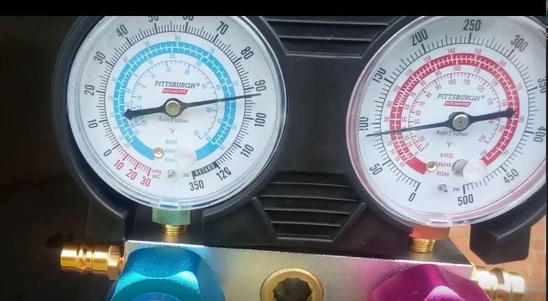

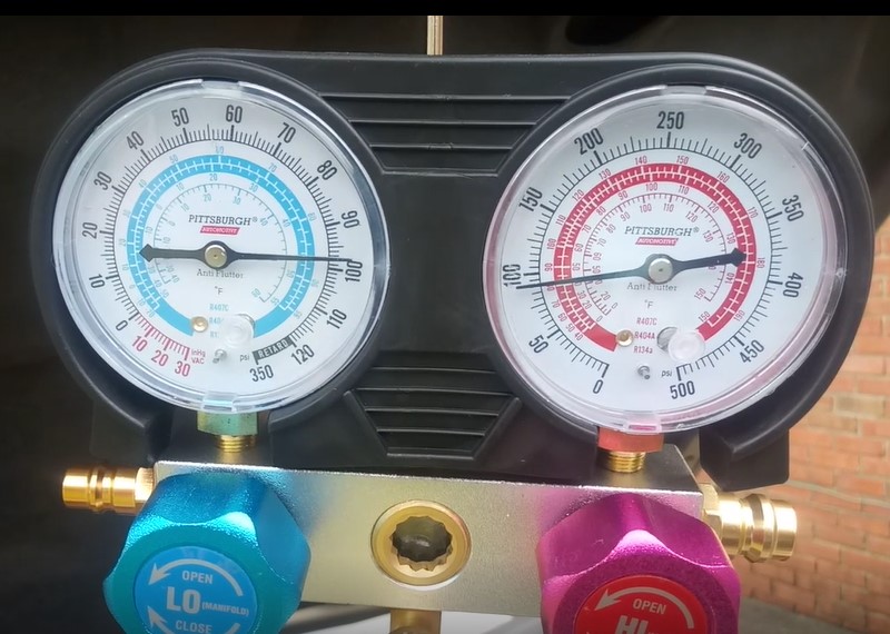

an this are the pleasures at 85°F and car @2000rpm
low side 89
high side 95
low side 95
high side 90

The product you mentioned likely did more harm than good. Sounds like you overcharged the system because the HPRV discharged. As well, you introduced more oil, which it probably didn't need, and possibly sealer, which can badly clog-up a system. Check the instructions on the can to see whether sealer is mentioned.Carrillotj wrote: Thu Apr 22, 2021 4:29 am So I recharged the system added oil too. (did not have a/c gauges yet, used the Ac pro can gauge only filled to about 32 psi@72°F on the low side). The car was ok for a couple of weeks but I did notice I hissing sound. the blow valve on the compressor was opening so I guess I over filled it. the car is not blowing cold air anymore even though the compressor is still activating(the clutch is engaging).
This part of your post is somewhat confusing in that the car is turned off yet still running at 2,000 RPM. Probably a typo. So for our purposes, let's presume that the clutch is defective and isn't actually engaging, that the compressor itself isn't running and is dead (due either to internal or external causes) as Tim suggested earlier, and that you're currently reading only static pressures.Carrillotj wrote: Thu Apr 22, 2021 4:29 am finally go a set of gauges.

Given all of the above, I would approach this by recovering the charge (although many shops won't risk damage to their equipment if sealer is present in the system...again, check the can), evacuating, and recharging to spec (if the compressor will run, that is). That's the only way the gauge readings will mean anything for diagnostic purposes. If sealer WAS introduced into the system, and/or the clutch won't engage, and neither will the compressor, then you'll have to replace everything anyway and start from scratch.

Glad to learn that no sealer was added.
The three-ounce oil charge might be okay depending on how much oil was lost when the HPRV discharged some refrigerant (and oil). But that's pure guesswork. It's always better to have a little too much oil, within reason, than not enough. From what I've read, Ice 32 is relatively benign and should be okay.
I would say again that your best option at this point is to recover, evacuate, recharge to spec, and then check pressures, center vent temps, and monitor how the system operates on the road. You'll need to have the correct refrigerant charge before any testing can be done.

Most modern oil companies will already use an oil enhancer. Ice32 is just another enhancer, IMO. I give them credit. They have sold a lot of product.
