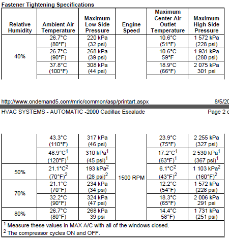

Re: Pressures.
Tim:
I use the ambient factor to evaluate a system.
Biggest problem is testing parameters. Constant issue here on the forum, with people posting idle speed pressures.
With the doors open, cabin fan on highest speed and engine RPM above 1800 I look for the high side to be
Between 2.4 to 2.7 times ambient temperature. I see those pressures as "normal" for 134a
If it is 112f outside I fully expect to see 300+ PSI on the high side. If I see anything less than 265 PSI, I begin to think the compressor is tired.
If I see much over 2.7x under load test, I start with the condenser and airflow.

Re: Pressures.
Re: Pressures.
Interesting. That chart supports my feeling that 3.0 x ambient is a maximum pressure.
Which vehicle is that?
Posts: 1394
Re: Pressures.
20 Escalade
I just found this going through old files on my systems. The main point in me starting this thread is there is no magic pressure reading to achieve. We can't always say your high is too high at 210psi. When we do not know the variables, we could lead someone to try and achieve an impossible number. That is not to say bad advice has been given!
