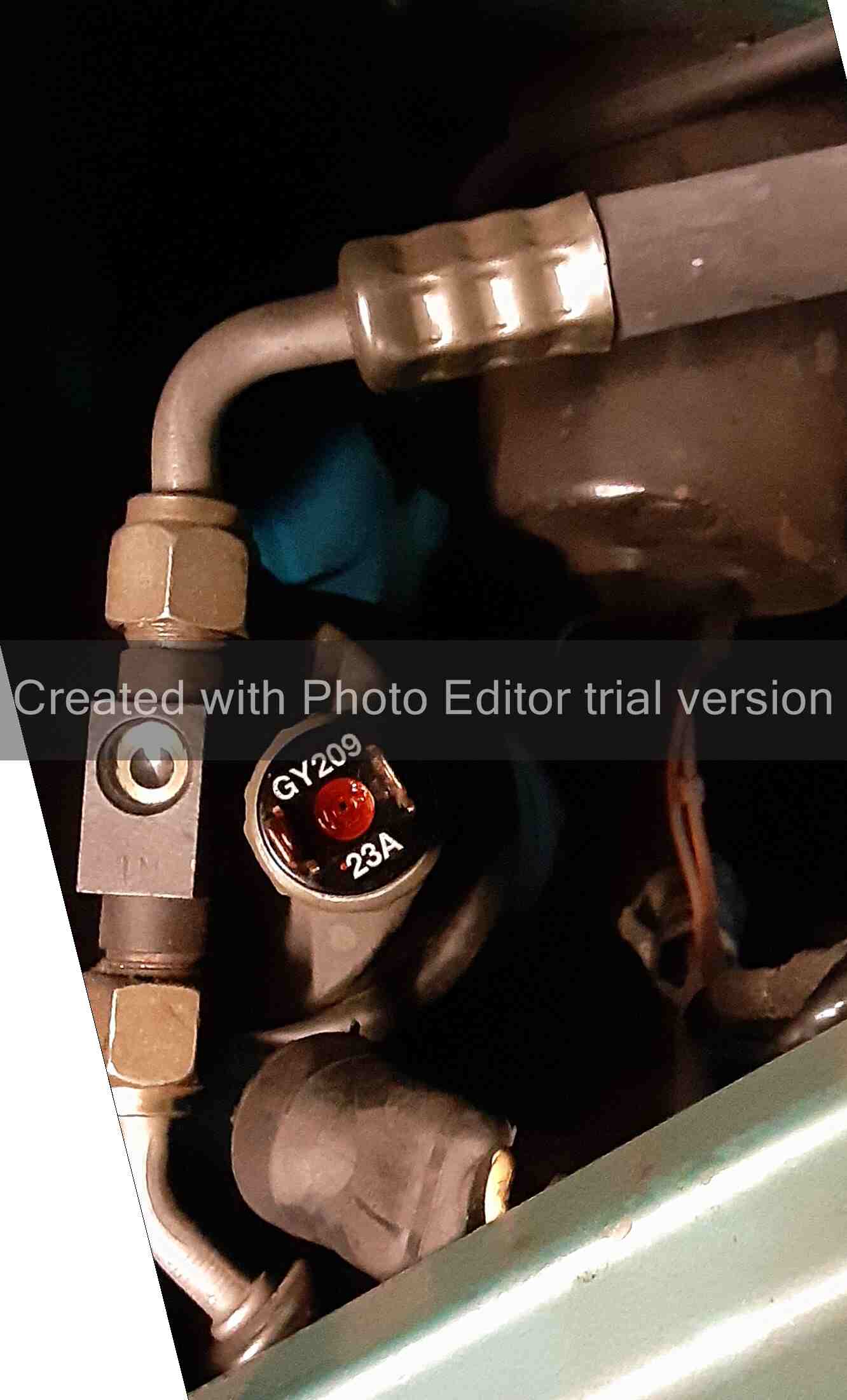

Parker filter w/ U.A.C. GY209 press switch (see images)

I installed this system in '13 though I started gathering some A/C parts as early '83. After buying an older F150 that had suffered Black Death and working thru repairing that, with much information gleaned from this forum, I finally did the A/C in my Falcon. Only 18,000 miles since the A/C was installed - probably about 25 to 30% of the driving with the A/C on. Suddenly the A/C does not work unless I jumper the pressure switch. Filter is a Parker and I presume the switch was preinstalled. Current switch is for 134A not R12. I am guessing the switch has both a high and low limit based on the numbers. There appears to be continuity across the switch - using a multimeter I read about 45 ohm - guessing its not passing current? How do I diagnose the problem? If the switch is bad, I presume the system must be evacuated to replace - correct? I've never had a system evacuated - will the evacuation also remove the oil in the system? I have a virtually empty 20lb R12 jug, would it be common for the evacuated R12 to be put into my container? If the switch is bad - how do I go about sourcing a replacement - what specs / criteria? I would presume this is something I could source from the forum sponsor.
As background: R12 system. Gages connected to ports on the comp. 85F amb about 60% RH. 1500 rpm gages read: 10 to 10.5 psi suction port, 270 to 275 pressure port. 38F with thermometer in the fins 1.5 hrs later, 88 F amb, engine compartment still warmer than amb, opening the gages to equalize pressure = 95 psi. Driving, about 88F amb, max A/C, surface streets, 30F in fins with just a light frost sheen on the copper tubes in the evap.

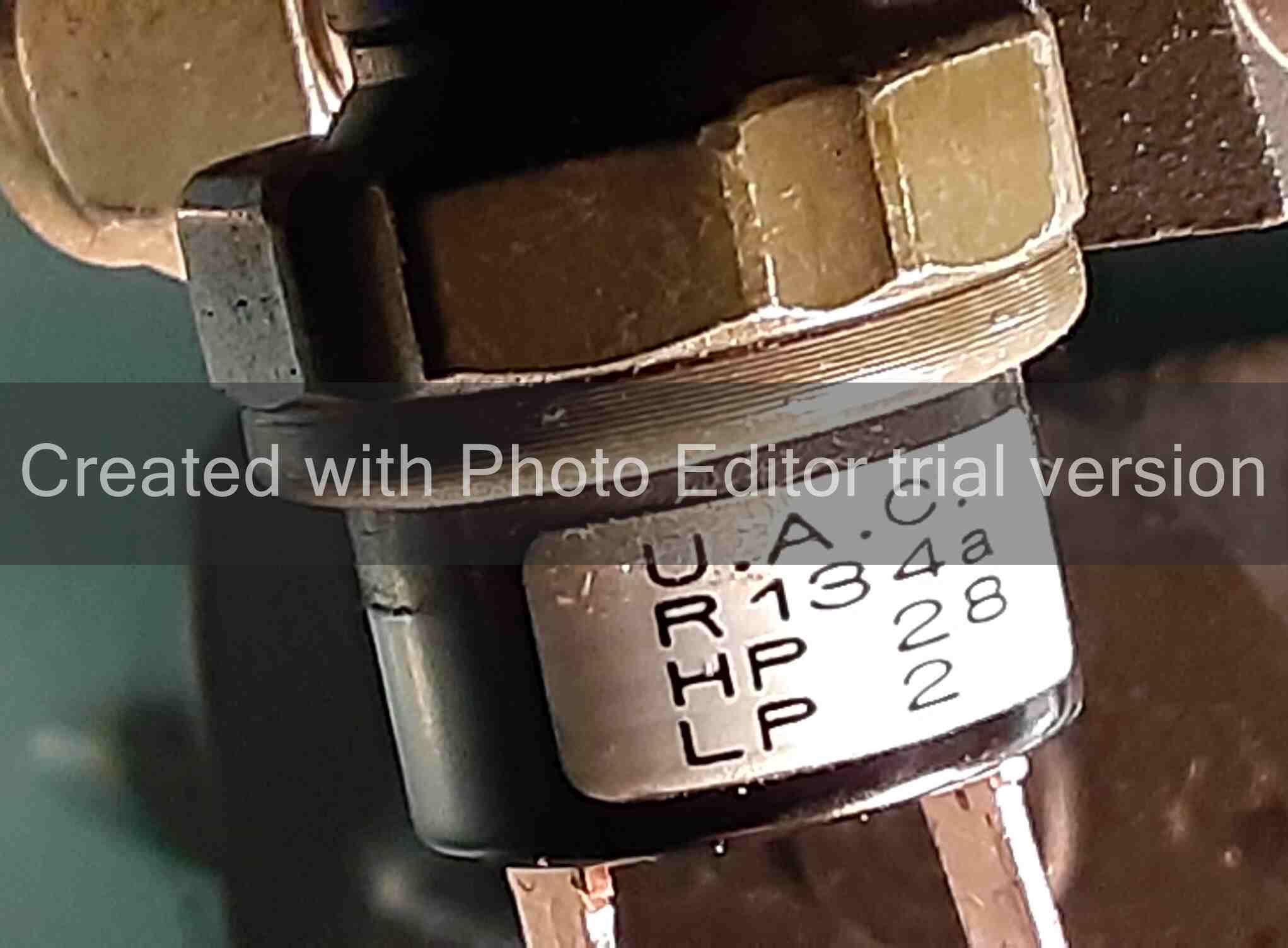

aribert wrote: Tue Jul 19, 2022 8:22 am I am guessing the switch has both a high and low limit based on the numbers.
That's correct. It's called a binary switch.
aribert wrote: Tue Jul 19, 2022 8:22 am There appears to be continuity across the switch - using a multimeter I read about 45 ohm - guessing its not passing current? How do I diagnose the problem?
If the system has a low charge, which is what I suspect, the switch is doing its job. With the ignition and the A/C on, do you have 12-13 volts on one of the wires leading to the switch?

Rather than searching for a new switch, which it might not need, first ensure that you have the correct charge in the system. I suspect that it's just low on refrigerant due to a leak. With a car this old, it has a sight glass (S/G) on the Parker receiver/dryer. Add some R-12 to the low side via an R-12 Manifold Gauge Set until the compressor engages and you start to see some bubbles and/or foam in the S/G. Then proceed to "sniff" the system with an electronic refrigerant detector to find the leak(s).
After the leaks are fixed, re-charge the system by monitoring the S/G as before. Continue slowly adding refrigerant a little at a time until the S/G clears, then add an ounce or two more. That will result in a full charge, which should restore good cooling as the temperature measured at the center vent.

Yesterday I slowly added refrigerant until the low side was reading 14 psi and the temperature at the evap coil got progressively higher until the temp in between the fins was in the very high 40s F. I kept observing the sight glass and never saw any bubbles or foaming as I added refrigerant. At that point I saw no reason to continue and I bled the system back down to about 10.5 psi on the suction side and evap fin temps were back into the mid/upper 30s F. I'm pleased with the cooling ability of the system currently (if the switch is jumpered).
The low pressure value seems way low to me but that might be because I am thinking of more recent experience with 134a where I am typically in the 25 to 35 psi range on the suction side. Might there be a different problem that where the suction side pressure is low but the system still cools well?
I will check for voltage at the switch plug tomorrow morning. I expect to find voltage there since the moment the switch socket is jumpered, the compressor clutch engages.
Looking at the switch - are the numbers on the side of the switch (2,28) the pressure set points of the switch? If so, what units, since PSI does not make any sense to me (I would expect the high limit of the switch to be greater than 28 psi).
