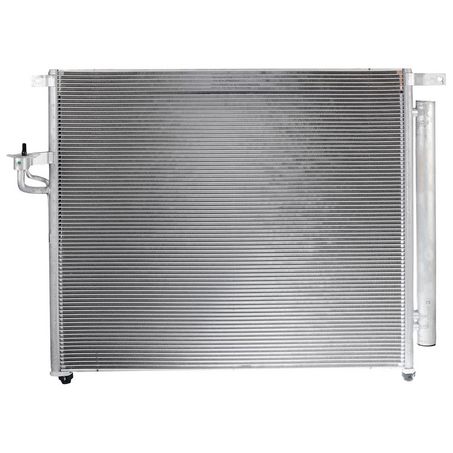

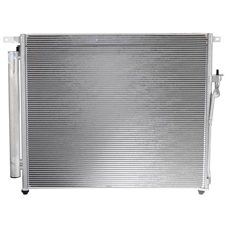

(NOTE: The first photo is how you would see the condenser if you were standing in front of the vehicle)
Another Ford Ranger AC Issue
- Ford Ranger Condenser.jpg (28.12 KiB) Viewed 33269 times
- Ford Ranger Condenser (1).jpg (24.85 KiB) Viewed 33269 times

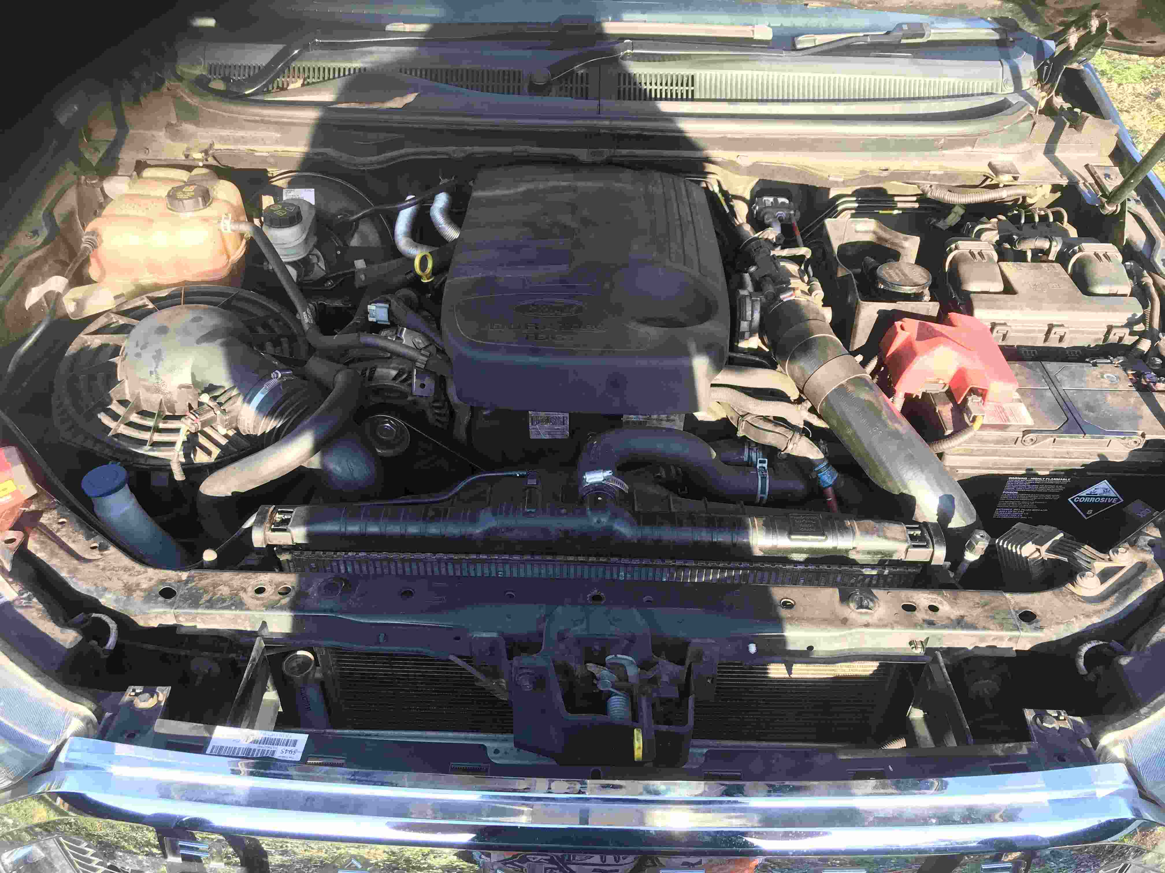

I've attached some photos of the engine set up, turbo set up, heat exchanger set up & condenser I/O plumbing.
The turbo doesn't have a blanket on it but it does have a heat shield - same thing? It is also on the left hand side of the engine but the compressor & AC piping is all on the right hand side (when standing in front of the vehicle).
The heat exchangers are arranged in this order: intercooler up front, condenser in the middle, radiator at the back.
As for the condenser I/O pipes. I removed the turbo hose (intercooler-to-throttle body) & the I/O is a junction. Because the turbo hose was in the way, I took temp readings at pipes just outside the junction. I also did not put black tape on the aluminum pipes when I took the readings. If you look at the condenser photos you can see a thin pipe that starts near the bottom of the condenser. It looks like this pipe comes up to the junction and has two branches - one for the high side service port (yellow circle) & one which which goes to the TX valve (red circle). I measured outlet temp at the piping just before the service port maybe this why my readings are off.

Re: Another Ford Ranger AC Issue
When you repeat pressures please have engine at 1500 RPM, windows down, ac max fan and max cool, and hopefully a digital thermometer in each vent in succession, as well as provide ambient. These are standard test conditions for an AC pro.
I need to study the pix more carefully they are a bit hard to view. Your shadow came out nicely, tho.
We would want the condenser I/O readings under those same conditions.
A heat shield is not the same as a turbo blanket, which wraps around the entire turbo body. Turbos raise the underhood temps considerably

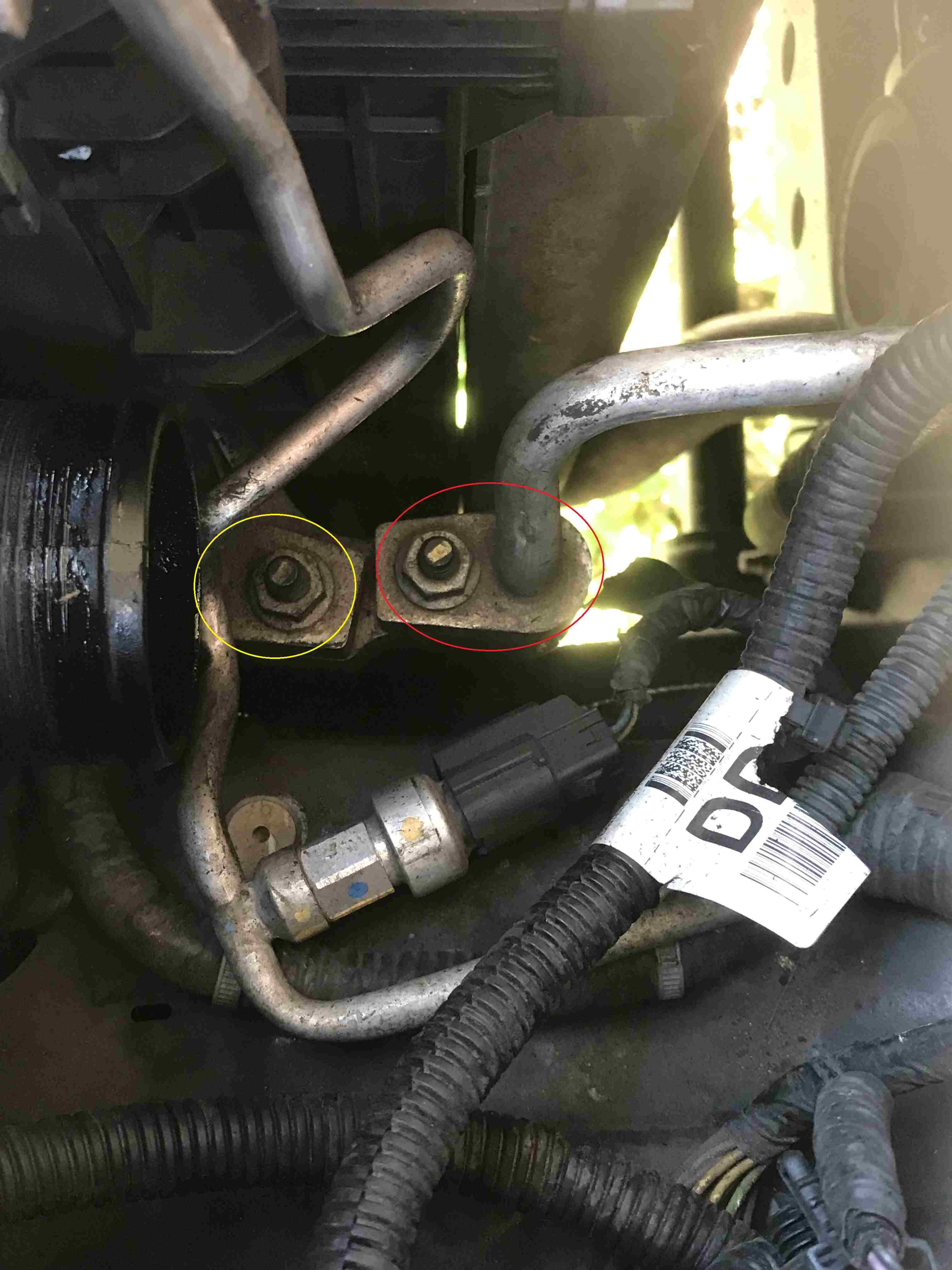

Just re-read my second post and there is a mistake.
The yellow circled pipe is the condenser outlet which has the two branches.
The red circled pipe is the condenser inlet.

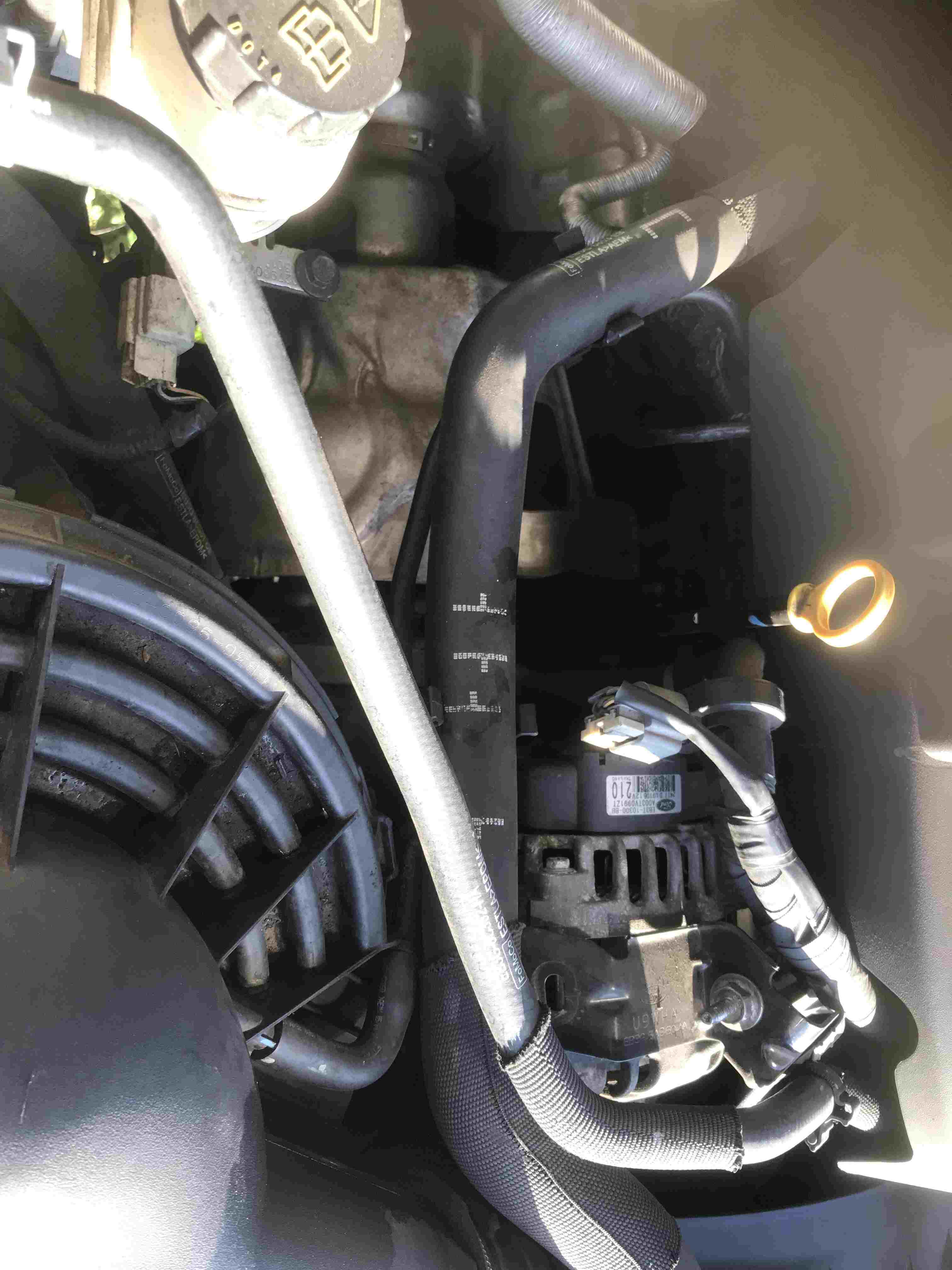

In the photo with the alternator, the turbo is behind & lower than the alternator. Can’t see it because it’s covered by a heat shield.
Why are there 2 branches? Is this a dual air system?
Where do they go to?
- Posts: 1822
IMHO, I don't think so. I believe it has left and right dash controls for the driver and passenger, and possibly, the rear passengers if it's an extended cab truck.tbirdtbird wrote: Wed Nov 02, 2022 3:55 pm Why are there 2 branches? Is this a dual air system?
The branch going up goes to the high side service/gauge porttbirdtbird wrote: Wed Nov 02, 2022 3:55 pm Why are there 2 branches? Is this a dual air system?
The branch going to the right (with HPCO switch/sensor) goes to the TX valve
