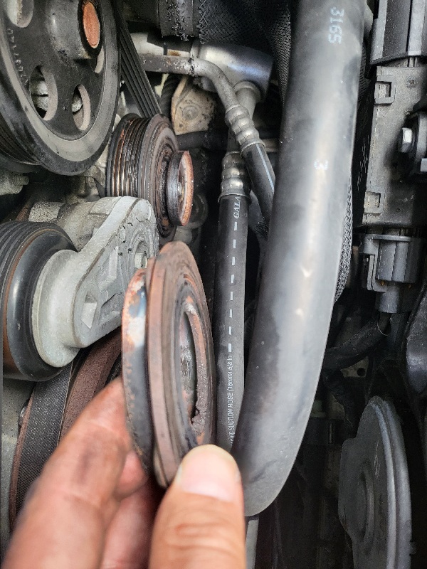

Here is a pic of what's left of the clutch. The piece I'm grabbing and turning is on the compressor, the center ring looking thing. Not what is in my hand
I found a clutch kit online and it's over $100. I think a new compressor is around $400. Then I'd have to have an ac shop refill it.
It's very tight access but if I remive a few bolts it might drop down a bit to work on.

"When I turn the center shaft by hand it is tough, it turns about a 1/4, the gets tight, I hear/feel a click and then it turns...over and over again."
Bad news.
"I'm thinking maybe the compressor went bad and then caused the clutch to break off. " Correct.
How many miles out of curiosity. Very few compressors will give you much more than 100K.
Also, since the comp has grenaded, there is now shrapnel downstream waiting to clog up your system. The line from the comp to the condenser must be changed out, and the condenser must be changed. A modern condenser cannot be flushed. If you have a TXV, that will need replacing, as well as the receiver dryer and the associated lines from the condenser to the evap
Not a job for the faint of heart
Bad news.
