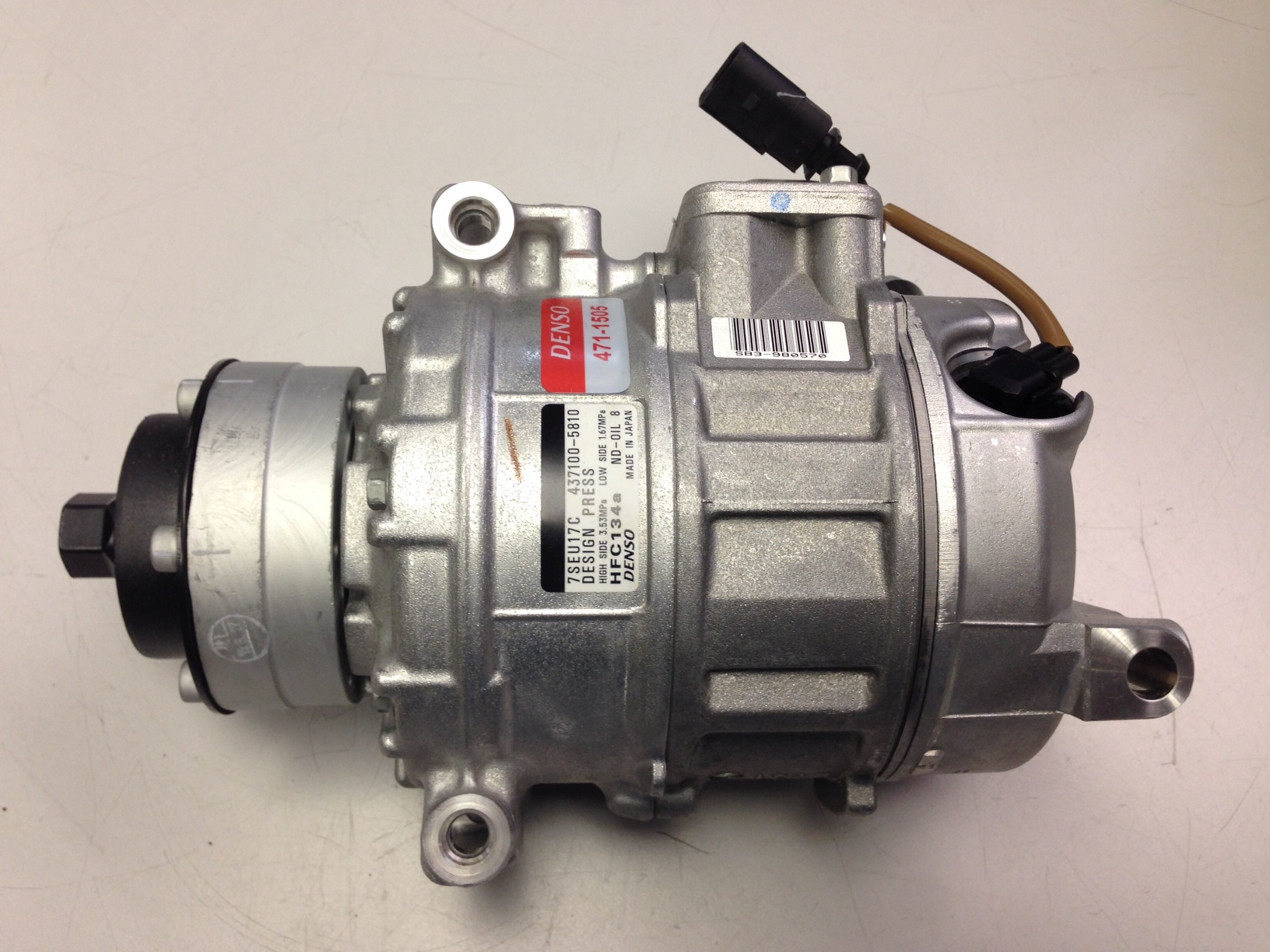

Electric direct drive compressor. 100% make sure the charge level is perfect. I can't tell if that's a speed sensor, probably, or a control valve at the switch plug base.
