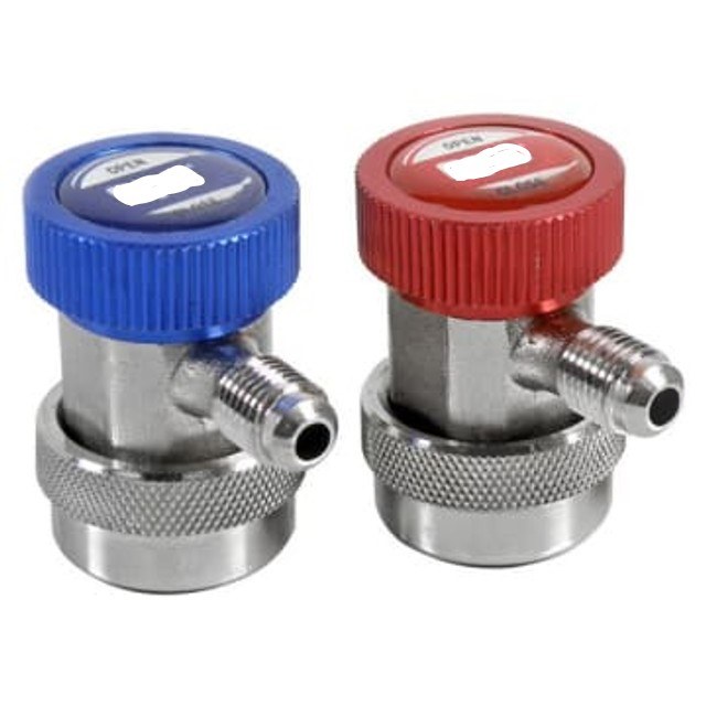

Also, make sure that you rotate the thumbwheel on your adapter clockwise to open the port, which is not intuitive.
Do your adapters look like these? If so, they should work.
- ServicePortAdapters.jpg (48.53 KiB) Viewed 101662 times

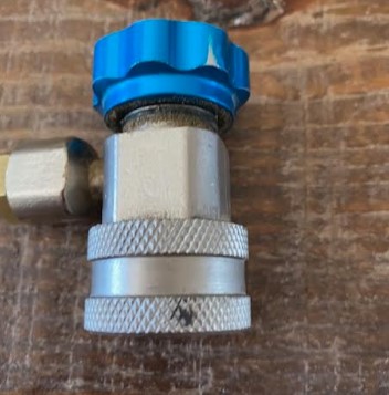

Re: 2008 Mazda 3 Low pessure port gauge fitting size
Here is my LPS fitting
- LPS HOSE FITTINGS 3.jpg (31.39 KiB) Viewed 101659 times
Examine the depth to the depressor when the knob is in the open position vs the closed position.
I have seen the depressor knobs marked backwards.
