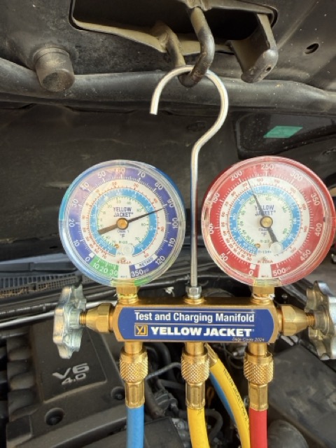

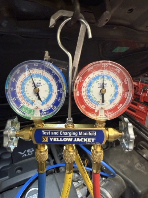

Hello, need some help in troubleshooting my truck.
I’m not professional HVAC tech, but did my own compressor/radiator/valve replacement, vacuum pull and recharge AC on my old car.
2019 Nissan Frontier, 70k miles. Rebuild title. Was hit at right front side. Own almost a year.
AC is barely blowing some cold in Texas heat. Compressor works on and off.
Static pressure was around 100 psi with 95F ambient temperature.
I drained some freon.
Didn’t help much. Attaching video of gauges.
Need some guidance.
Gauges recording: https://youtube.com/shorts/1Hh5JaIMgZU?feature=share
IMG_2911 Medium.jpg (91.68 KiB) Viewed 22383 times
IMG_2914 Medium.jpg (100.09 KiB) Viewed 22383 times

I suggest reclaiming the refrigerant. Pull a vacuum, add back the specific refrigerant, and post your readings. You did not list engine size.

No offense, but I'm going to disagree. An expansion valve system should not run at 40 PSI during high idle. He needs to get back to the OE specs; otherwise, they are just guessing at the problem. If 40/300 post OE spec. Then you can start working on the problem. Might spray a mist of water on the condenser while running and see if pressure drops and cooling begins.

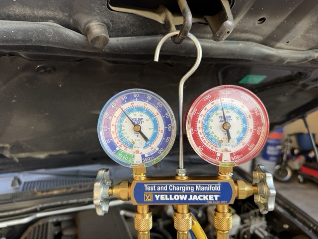

Pulled the vacuum, recharged 24 oz. Didn't help much.
But at least static pressure is 70 now at 95F.
AC working in same sequence - short start/stop.
Took it for a ride - min air temp from vent - 68F.
Attaching gauges video: https://youtube.com/shorts/0Quf4k-mAGo?feature=share
Running pressure now 50/250
System spitting out a lot of yellow dye.
Possible someone tried to find a leak and dumped stop-leak goo?
IMG_2927 Medium.jpeg (100.04 KiB) Viewed 22209 times

Mist the condenser and post pressures & temp.
