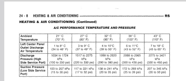

I personally find it stunning that the FSM would publish erroneous information on the vehicles they built.
According to their information, 225psi would correlate to an ambient of closer to 80F ?
The FSM figures are also for R134a which is what I am using in it.
Would you mind telling me how you came up with your ~225 psi figure?
FSM AC Pressures Chart.jpg (57.26 KiB) Viewed 24689 times

Diametric wrote: Wed Aug 19, 2026 7:39 am I personally find it stunning that the FSM would publish erroneous information on the vehicles they built.
Decades of experience :-)
But seriously, MVAC techs generally don't use pressure/temperature charts as they can sometimes be misleading.
One way to judge whether the high-side system pressures are "in the ballpark," so to speak, are by using the following multipliers. These multipliers reportedly say that the high-side pressures should be somewhere in the area of 2.2 to 2.5 times the ambient temperature.
For instance, the ambient temperature at your location is 96°F, so 2.2x96=211 PSI; 2.3x96=220 PSI; 2.4x96=230 PSI; and 2.5x96=240 PSI. Presuming that these multipliers are valid, we could say that the acceptable high-side pressures range from 211 PSI to 240 PSI, which sound reasonable based on the condensing factor.
However, it's a given technician's judgement call. I tend to be conservative when it comes to system pressures, so I said ~225 PSI with decent condensing. The decided-on high-side pressure range can and does fluctuate, as indicated by (~), depending on whether the condenser is unplugged or partially plugged with internal debris, whether something is compromising airflow through the condenser core, whether the system has a serpentine or parallel-flow condenser, and of course the ambient temperature.
