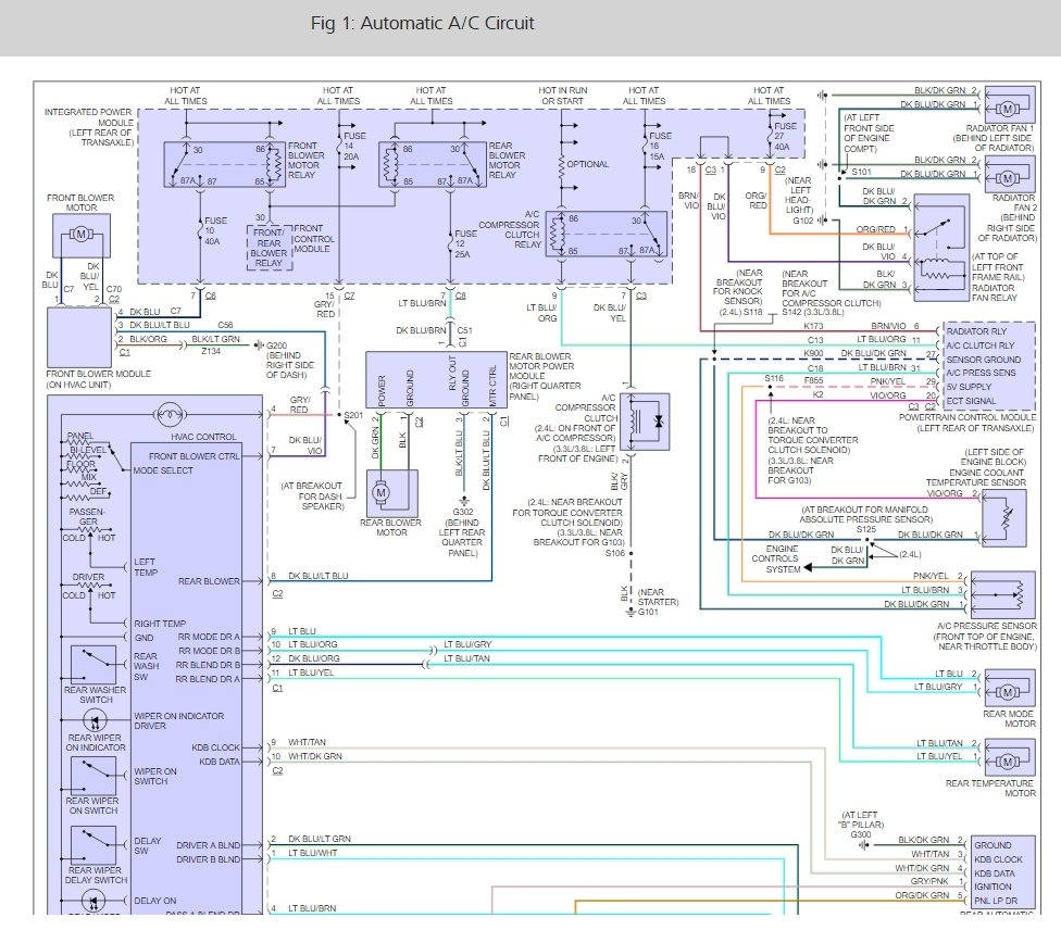

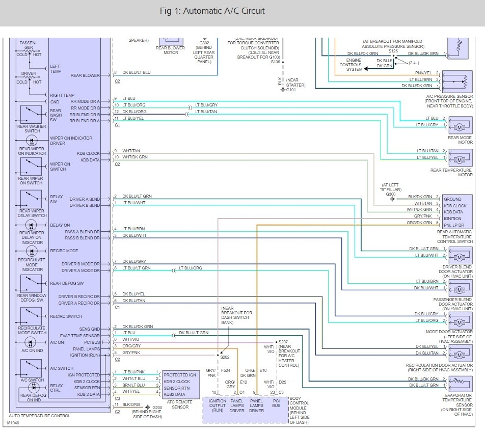

Here are links to the a/c wiring if anyone cares to have a look.
https://www.2carpros.com/images/questio ... iginal.jpg
It's been a fairly mild summer so far here in KS, only a few days in the 90's, but this won't go on for ever. With a 30 min one way commute to work and a 9 y/o kid playing a lot of baseball riding home in a sauna isn't fun for anyone.

You get clutch activation when you jumper the relay power contacts so the wire from relay to clutch and clutch coil are good. The power train control module supplies ground for the clutch relay. The pcm monitors the pressure switch and if it is in the correct range the pcm pulls the relay coil to ground closing the contacts and sends power to the clutch coil. So check the wiring from relay to pcm (ltblu/org)and from pressure switch to pcm. You say the pressure switch is good, but is it sending the correct voltage to the pcm? Check the connectors at the pcm and pressure switch. You can jumper to ground the relay pin 85 and see if the relay pulls in and the clutch pulls in. If yes then wiring to pcm, pressure switch wiring to and from pcm, pcm and pressure switch are the suspects.
Hope this helps.
